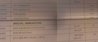

1,132
Looks like MAC used the same .355 130 gr bullet for their 9mm and 380 ammo.
Yes that’s what I was assuming as well. They used the same bullet for both calibers. I feel like it was probably more effective in the .380 caliber, though I do know that their .380 was +P so it likely required the heavier projectile to remain subsonic and achieve the volume they were looking for. I have never seen any other .380 available that’s over 95gr. I imagine it was a very quiet round. That said, I don’t think the 130gr bullet in the +P 9mm cartridge would perform as quietly as it does in the .380 or as quietly as the newer heavier subsonic stuff that’s 147gr and up.
