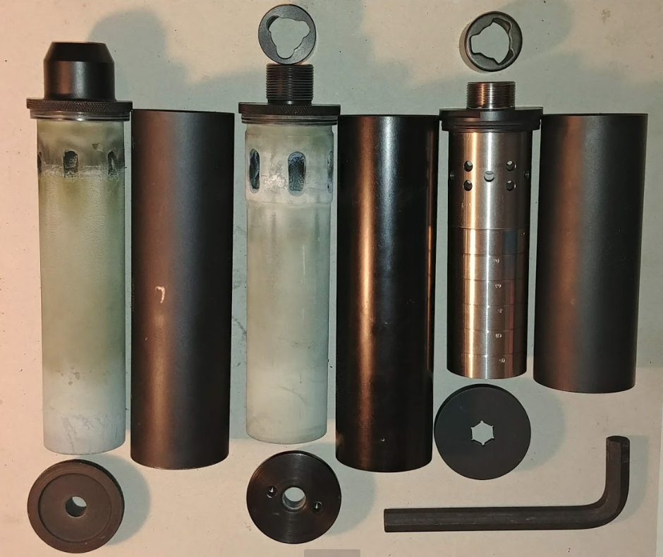

Compared to the rest in the pic how do you rate the Octane?
How was the tone/sound/back pressure?
It sounds pretty good. I like it better than the old Gemtech Mossad which has a higher pitch to my ears. It is a high back pressure can. Definitely get gassed using it vs any of the coax designs.

Similar but not the same. A lot more machine work is involved with the Curtis Tactical variants.
As you can see in my pic below, the baffles are threaded together eliminating the need for an inner tube which is more weight.
The Phoenix and AWC both use aluminum tubes which you shouldn't use harsh chemicals on. The old MK9 and MK9K used SS stamped baffles but the MK9K had an aluminum blast baffle due to ease of machining. The Phoenix also uses aluminum baffles.
I don't want aluminum used for my baffles at all.
The Curtis Tactical cans are all SS (baffles) and Titanium (tube). The CT9K is shorter and LIGHTER then the old MK9K since it eliminates the inner tube.
He can make the baffles out of Titanium as well for more money of course.
