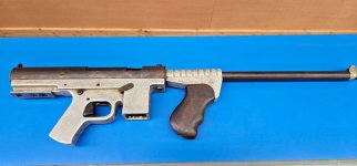

So I recently won an auction for a hammered Volunteer Enterprises 45 Open Bolt gun that is missing the stock. I already have one of these in much better condition and was contemplating making it cosmeticly look like something else (M3 Grease Gun). What are you thoughts? Should I get a replacement Thompson stock and call it a day, or make it into something else (I don't want to touch the inside guts, since it is a legal Open Bolt firearm). I know Grease Gun parts have become harder to find, but there are several other submachine guns that have a similar stock. I would also need to remove the forward grip and sight, and put a front sight on top of the tool front end to line up with the back sight.

full 16" had to take the soumi sight down a little to get the elevation correct still need to sand and re paint or park .will have to post pics next week
and oddly enough the wannabe tommy grip is more comfy then a Thompson straight grip
I think the Soumi barrel shroud would be awesome. How did you hold it in place?
I think this with the sliding stock off of the FBP M/948 will look killer.
Now I need to find someone that can fabricate this for me. I'm set up to do Cerikote to refinish, but that's not going to help.

held onto hand grip with set screws to help adjust sighting it in 4 way slight adjustment, then file in front sight to zero
