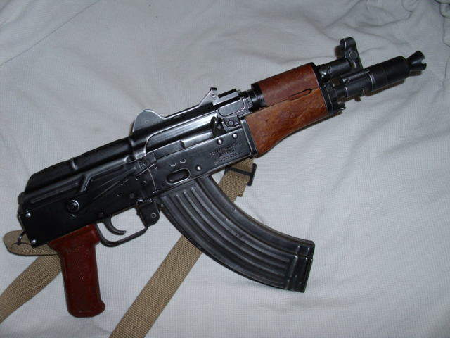

Draco AK pistol into BFPU Krink. This included making my own hinge block 'cause Krinks' top covers don't come off, they just swing up for disassembly. Barrel shortened to 210mm. Shorten gas tube and remake gas tube end including making dies to iron out and reform gas tube piston guide ribs. Shorten upper and lower hand guards then making new front and rear hand guard sheet metal.
Study lots of AKs in action pictures to see where the wear marks on the finish should be to get that seen-lots-of-action look.

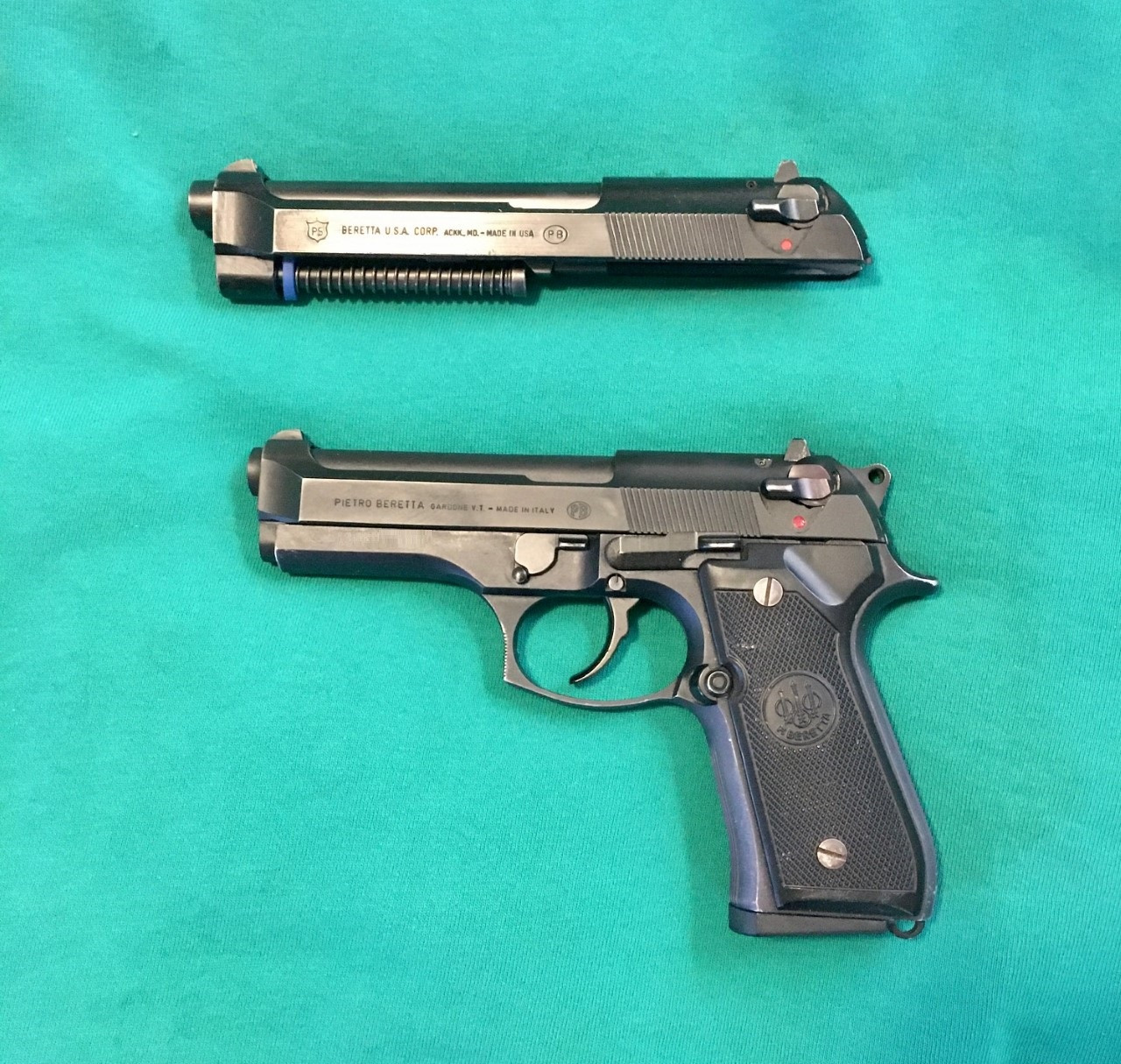

Beretta 92F reworked to accept 92F Compact slide. Full-sized frame with the shorter slide seems to be the best of both worlds for me. I also did away with the last round, hold open 'feature'. In a tactical situation, nothing says "Hey everybody, I'm out of ammo" like having the slide stay back after the last round is fired.
