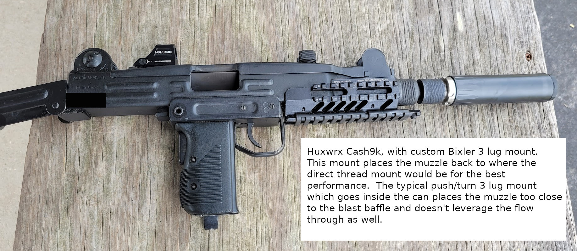

What is the actual thread pattern on outside of AWC MK9 can?
Bixler 3-lug goes over it.
I should probably know that off the top of my head as I just made the Bixler mount below:
It is 15/16 - 20 TPI
http://theoreticalmachinist.com/Threads_UnifiedImperial.aspx#google_vignette
Mine has a major diameter of .9325 which is within tolerance by the link above. If you need another nut, Joe at Shaw Armament sells them.

Sure you can use an ASR mount or a Griffin EZ lok mount which is gaining popularity.
My personal preference again is the native UZI barrel nut mount designed to be used with a cut down UZI barrel as the most compact setup compared to anything else and I also think the best looking.
I personally like the 3 lug second since I also have an MP5 and have standardized on 3 lug for my 9mm M16 builds as well.
Another reason is 3 lug has been around for what over 30 years now and today there are several quality sources for the adatpers to screw on the barrel and thread the way I have discussed many times to match the full length of the adapter.
My preferred Bixler mount is also more solid and robust than the push / turn 3 lug mounts and also over 30 years old with expired patents and now made by Shaw Armament and now Hansohn Brothers will be making them at the end of the year as well. Not to mention they are not that complicated and I made my own as well.
So this is more of an 'open source' approach and no worries of company X,Y,Z not making the adapters and hopefully more people making the Bixler mounts but if you like the wobbly push / turn mount, there are MANY choices for those w/ no concerns of being locked into a particular vendor.
Contrast that with the amount of sources for XYZ proprietary mounts...many times only 1 source.

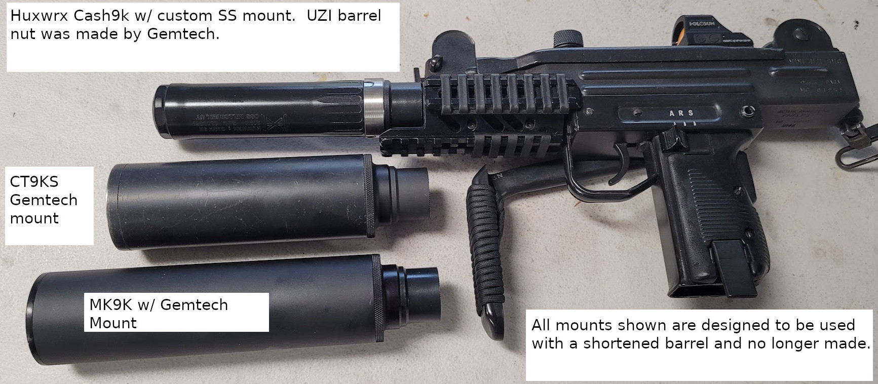

I made the one seen at the bottom of page one of this thread for myself. Not that pretty when you look at my welds but assembled you wouldn't know. Re-posted pics below for convenience.
I did that out of desperation as I saw no commercial offering so I had to make my own. After doing all the work, I just went back to my CT9KS...(which uses Gemtech MK9K mounts). I'll probably use the Bushwhacker on something else.
I also did a SS Alpha thread adapter pictured below.

Does the Bowers UZI barrel nut mount also align with the OD of the UZI barrel like the Gemtech one does? If not that may be the reason you had issues. I know the Liberty Mystic UZI mount does not and in fact it isn't even a close fit so it dumps a bunch of gas back into the receiver and even into the shooters eyes. My buddy had one and I cut it down and made it a short mount for him and had it use the OD of the barrel as a bearing surface like the old Gemtech ones.
