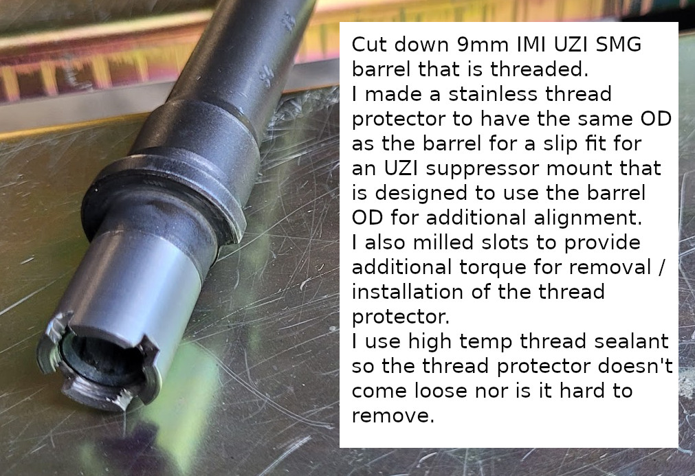

I may be able to do a few of these....
As I mentioned in the link above, below is a picture of some work I recently did.
This IMI barrel was already threaded so I made that adapter. If the barrel wasn't already threaded, I would just cut it down on the lathe instead of making the adapter.
Also, I noted in the AR15.com thread that the factory IMI Mini UZI compensated barrels have an OD of .620, full size UZI barrels are like .625 and the Gemtech MK9K rear mount ID is .6335"

Very interested.
I have a Phoenix, and spare barrels!
4,830
Very interested.
Email me directly and let me know what barrels you have and what you want done. As I mentioned above, I want to make sure they have the proper OD.
