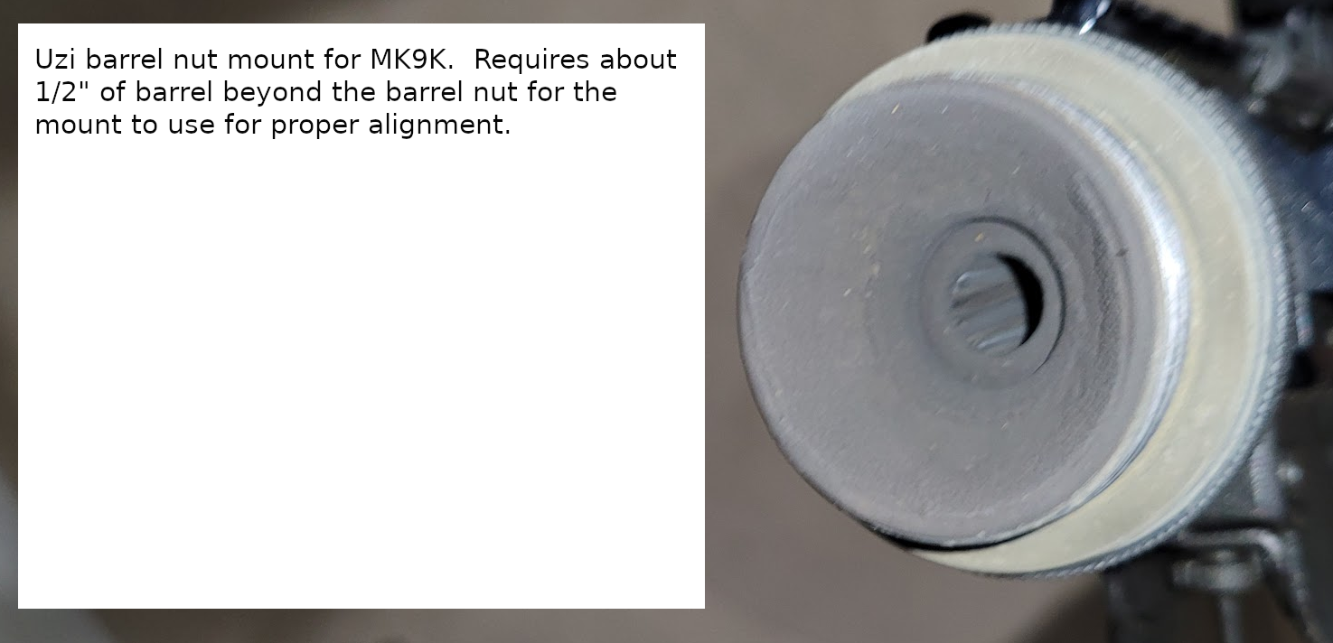

A female hub mount for the MK9K would be amazing.

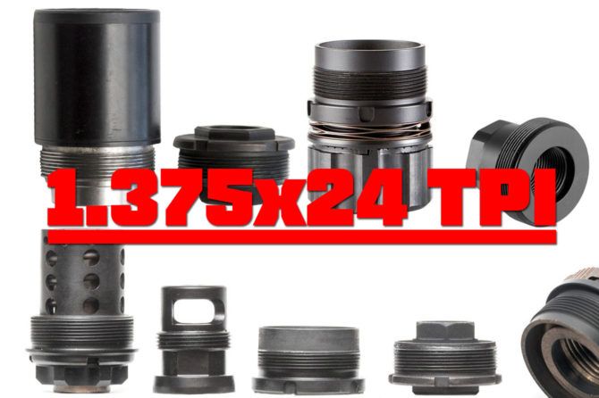

I put that in my first post...it is the industry standard 'Hub' thread which is 1.375x24...
See article below.
https://www.recoilweb.com/the-universal-silencer-standard-1-375x24-156634.html
Now regarding the length of the thread you can see that while the length of the threads appears the same as pictured below, some adapters have a a non-threaded area beyond the the threads that go into the suppressor as you can see below.
FWIW, I have the 3 lug adapter pictured in the bottom left that doesn't have that non-threaded area that is made by Griffin Armament and some other Griffin Armament mounts do have the non-threaded area so not sure why...maybe additional support for their cans but my Silencerco Omega doesn't have the non-threaded area.

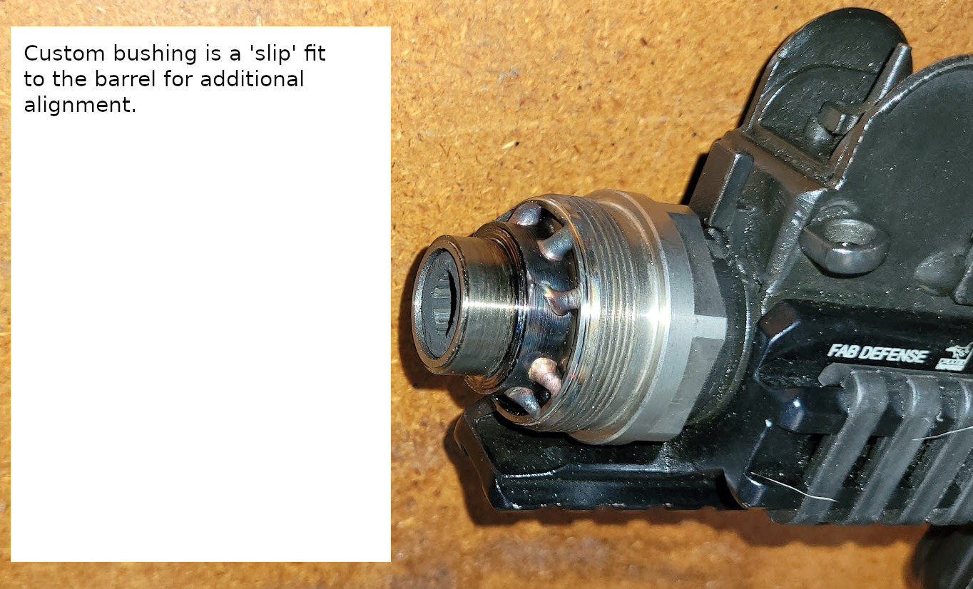

Yes but just about every hub compatible can that I'm talking about using this for accepts brakes, FHs or 3 lugs that go in deeper than a cut down Uzi barrel. I can't speak for all the Uzi enthusiasts in this thread but my appeal for something like this is to NOT use an obnoxiously long adapter that uses unmodified UZI barrels.
I may try to just modify a barrel nut to fit in a hub mount and TIG it in place and see how it works out.

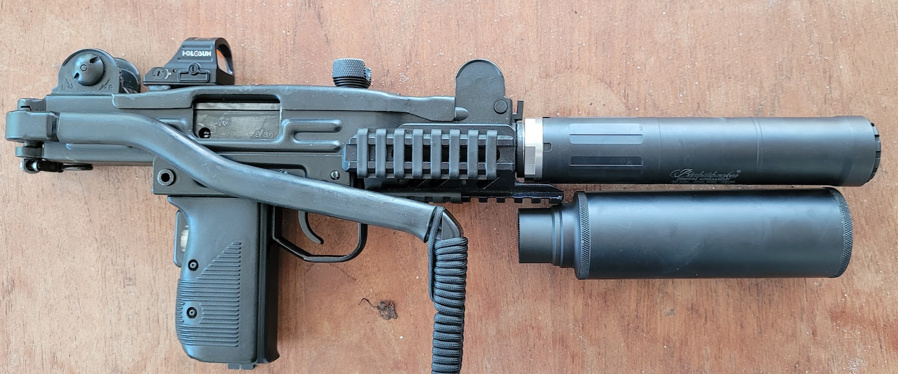

Done!...well probably need to sandblast and parkerize it at some point but good enough to shoot.
