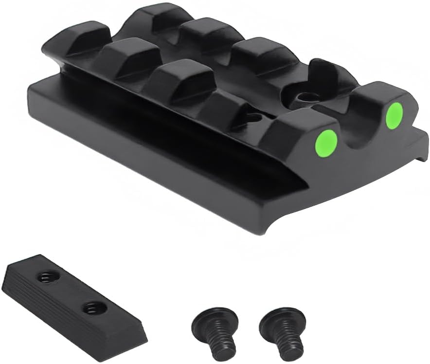

Kinda wish I got the TORO model so I could bolt weights to the sight mount. Oh well. When the side wears out I'll get a toro slide.
It says it takes glock sights so they make a keyed picatinny that I can mount weights too.
