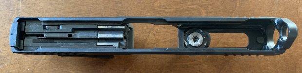

His 2.1 oz optic took the 1950 RPM down to a suppressed 1480 RPM. It's a good place to start with weights.
1,478
The toro models are already cut for optics, how about just a thick lead sheet screwed into it? Or get fancy and make a mold to make it look factory.

What’s your bolt idea?
I think I have some lead wire. My first idea was to just try wrapping some of that around the RDS to test the concept. I should be able to try it this afternoon

I wonder if a block of material could be milled as a heavy back plate? It would look like a switch. :)
I have a 2.8" barrel 22LR pistol and velocity suffers so I wanted something with more back pressure.

I'd start super heavy taking off a bit everytime till it Works and keeping track of weight removed.
Once done remill one with the finger loop and correct weight so it does not look like a G switch.

I added weight to my slide and it ran subsonic frt with a can. It worked with CCI and Rem subs. This gun hates everything aguilla
If I go with a solution like this I could use two recessed bolts with a flat plate on top of the slide. That would connect the two bolts and keep them from moving under recoil.
The -10% spring will be here next week to try first

I ignored all your safety advice and just wrapped it around the RDS and then put electrical tape over it. It flew off after a short burst but then I knew I was onto something.
It just kinda flopped off
And I was squeezing my eyes shut for safety so I had that protection in place. ?
Has anyone talked about what the problem is with cans?
Either it has something to do with screwing up the barrel movement with extra weight and/or bolt bounce from faster slide cycling, or ???
