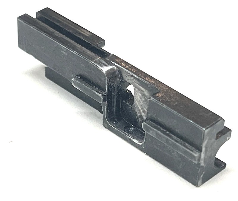

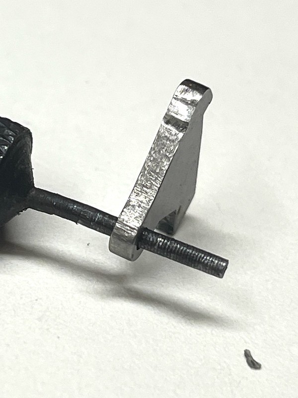

Except for the additional weight for suppressor use I don't see the need for the metal inserts. Your FRT isn't causing wear on my TX22 beyond the initial rounding off of the edge.

Actually I would want the cheapest more readily available part to wear out first so big win for you as you will be selling a bunch more :) But seriously those insert housings look to have the texture of a grinding wheel even if you made the frt out of hardened alloy tool steel its not going to last. Not the correct technology for the application.

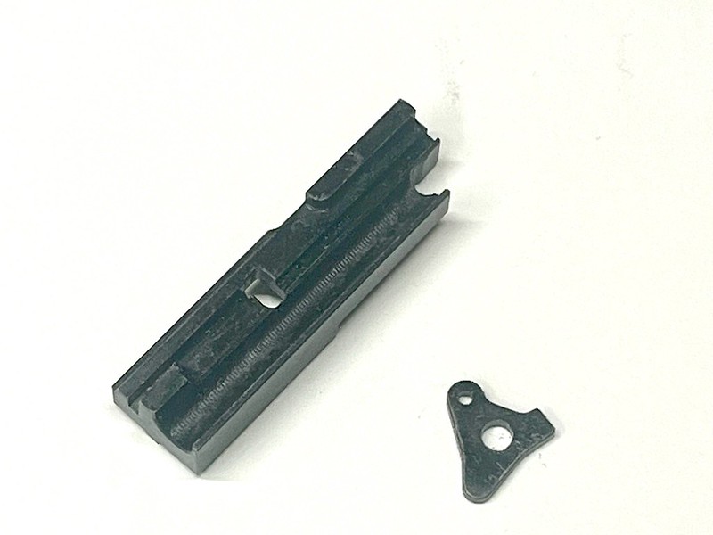

Tested my Stark80 CNC striker today. I tried with their CNC one side striker and their hardened FRT combo in 2 TX22s. Same result. Pistols failed to fire. Completely dead trigger. I think the FRT hole was too small and the FRT would not drop to allow the trigger to work.
I tried the ODD MFG FRT with the CNC steel Striker housing and had 100% function with the 220 rounds tested. It did damage the FRT but I will test again with a new FRT and radius on the housing.

When you talk to them you might suggest that they try regular CA260 brass for that striker housing. With lube it will have better wear resistance than the polymer part and not be so hard on the FRT piece.

My conclusion to the TX22 metal striker was not to use one. All 4 metal striker housings I tested, damaged the FRTs and reduced reliability. My TX22 V7 FRT does not need one anyway.
The better solution is to use a rate reducer/ charging handle made from metal to replace the plastic end plate. Mak91 is developing a modular/adjustable weighted solution. It's easier to install and adjust than a metal striker housings for variations in slide wight for suppressors use.
