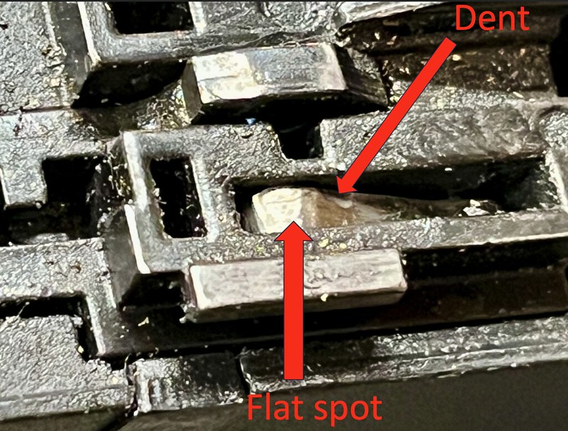

Thanks for the heads up on the back plate tho that isn’t the problem. Something’s not quite right because the slide increasingly fails to close and I’m now getting a lot of light primer strikes as well. I keep everything well lubed so that’s not the problem. I’m pulling the stainless inserts and will carefully compare them to the oem plastic ones. Will then reinstall the plastic inserts and go from there to troubleshoot.
Replying to myself again. Once I got to looking I could see the problem. The stainless insert that interacts with the frt is beating the crap out of the frt. The flattening and mushrooming of the frt was the likely cause of the malfunctions because once I filed and polished Strobro’s frt back into shape it worked perfectly… without the offending stainless insert. I at least was able to use the other stainless insert (16.88 g) for an internal weight. Anybody else who got these will have the same result, I’m certain of it. My advice to anyone making these inserts is to use brass or bronze or anything softer than the frt.

1,129
Thank you for that valuable input. Definitely something to watch out for when using a replacement insert.
Did you see any wear on the metal insert from the FRT? If not you might consider hitting it with a small file to round off the corner so it looks like a plastic one after a couple thousand rounds and then grease it up.

No wear on the stainless insert at all. The shiny spots you see are polishing that was done before testing and shipping. Good point about rounding off the corner on the insert. I have nothing to lose there since it seems not useable at this point.

Yah, I'd try rounding it just a little. You're correct on using a different material. Brass would be a logical place to start because it's fairly cheap and easy to machine. You might want to pass you experience to the place that made the insert. And then get them to join and sponsor this forum!!

I have 3 people who reported damage to my 304 SS FRTs. All were using the sintered SS striker housings from 701Boomskicks, TacticalRN and McCane Defense Co.
If you have prurchased a SS striker housing from one them, please keep an eye on the FRT. All of the housings were rough and needed fitting. All had the contact points smoothed/polished before use and left dents or flat spots on the FRT just like Carverpete's.
I'm going to advise that these housings not be used with the FRTs I sell. The housings are much harder than the 304 SS FRTs and will wear them easily.
