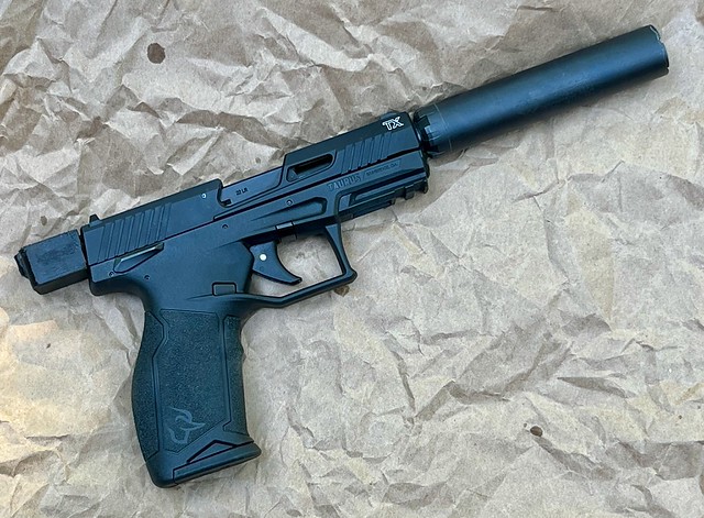

Root sent me a new 3D printed box so this time I hot glued a solid lead weight inside it permanently. I also drilled a hole through it from the back to make sure I could insert a tool to remove it. It also required a trim at the bottom, like the OEM plate to for slide disassembly while the weight box is attached.
Tests for 3-10 rd average with the 1.75oz back plate box weight:
CCI Subs 40 gr- 1217 RPM
CCI MM 40 gr- 1195 RPM
I definitely think the solution for suppressors use with FRTs and a non-optic cut slide (iron sights) is a long, 1.75 oz steel back plate. I hope the po po does not think it's a switch.

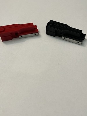

I have the new TX22 FRTs but they are the same size as last time, too small. The printed measurements are correct. The .step file is incorrect. I asked them to make the new parts to the scale of the printed measurements but the did not. Money and time down the drain. At some point I will try to get a better file made.
Until then here's other companies selling them for $45.

I tested the 1.75 oz box again today suppresses and not. The numbers are different than when the weight was on on top of the slide. Sometimes by more than 100 RPM. The average for 1.75 oz unsuppressed HV was 1415 RPM but Subs were unreliable. :unsure:
It looks like the 1.5 oz numbers are the sweet spot for HV and subs unsuppressed when using back of the slide weight. I'm going to need to verify all of this again.
1.5 oz weight on top, 1.5 oz weight on the back, 1.75 oz weight on top, 1.75 oz weight on the back, suppressed, unsuppressed, subsonic ammo, HV ammo. 3-10 rds averages for each. This hurts my brain.
I do know that the weight on the back looks better and would be easier to change around. I'm glad root sent 2 boxes. I guess the ideal weight is one that all configurations work.

The links you listed are very unreliable FRTs accourding to the link I sent you. Lots of those guys cheaped out and are RHheeeeeing they can't get reliability.
Some, no reset after the 1st shot, some a very short string and no reset.
If you compare the links above to the ty22 frt you will see they all have a different profile.
The ty22 nailed it with the geometry it seems.
Plug & play seems to be the 125.00 ty22 this thread is about.

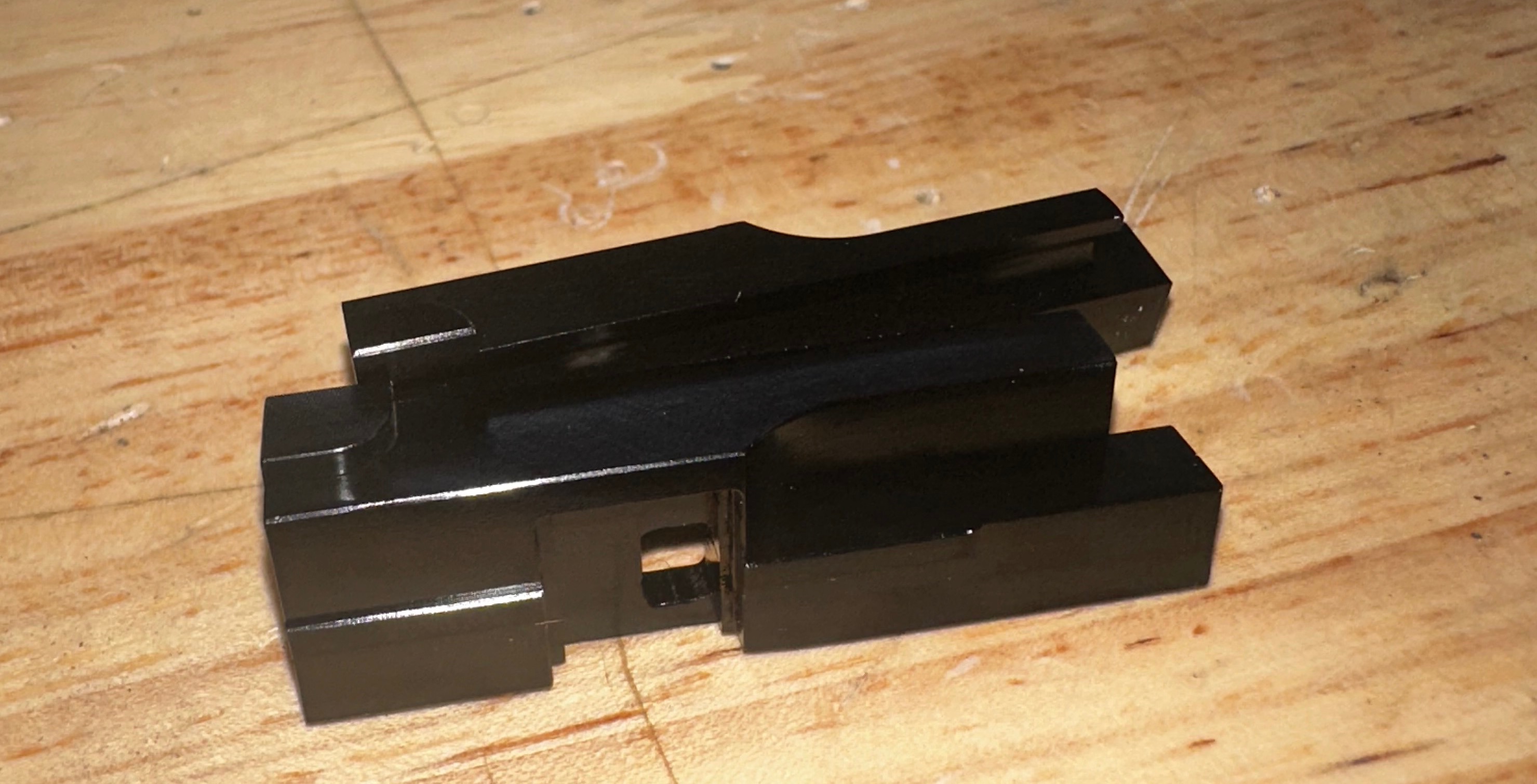

This is the wear from about 1K rounds with the FRT, That corner on the plastic striker housing should be square, like the other side of the striker block.

Can you somehow use the lightening holes in the slide to attach some weight? Run a few small screws and washers from the inside to hold a weight with nuts on the outside? Not as a permanent solution but for testing. Just brain farting here.
Yes. This is how I did my successful proof of concept to run suppressed with weight

It still functional with HV but not reliable with subs.
I just purchased a metal reinforced insert on ebay. I'll let you know how it works out.

I just checked out the plastic striker housing. There does not appear to have more wear. I have a metal reinforced one coming but i just want to take the OEM to the point were it fails. I'm going to need more ammo. It really is a fun little toy.
