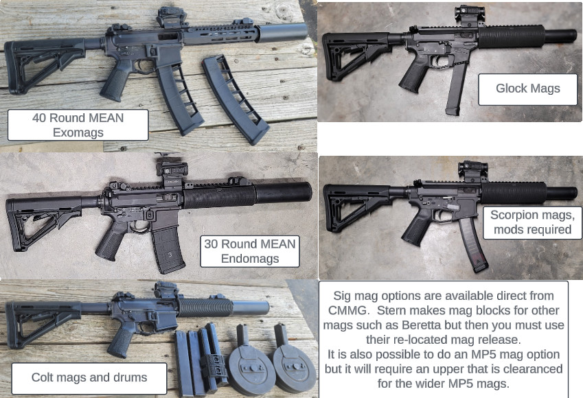

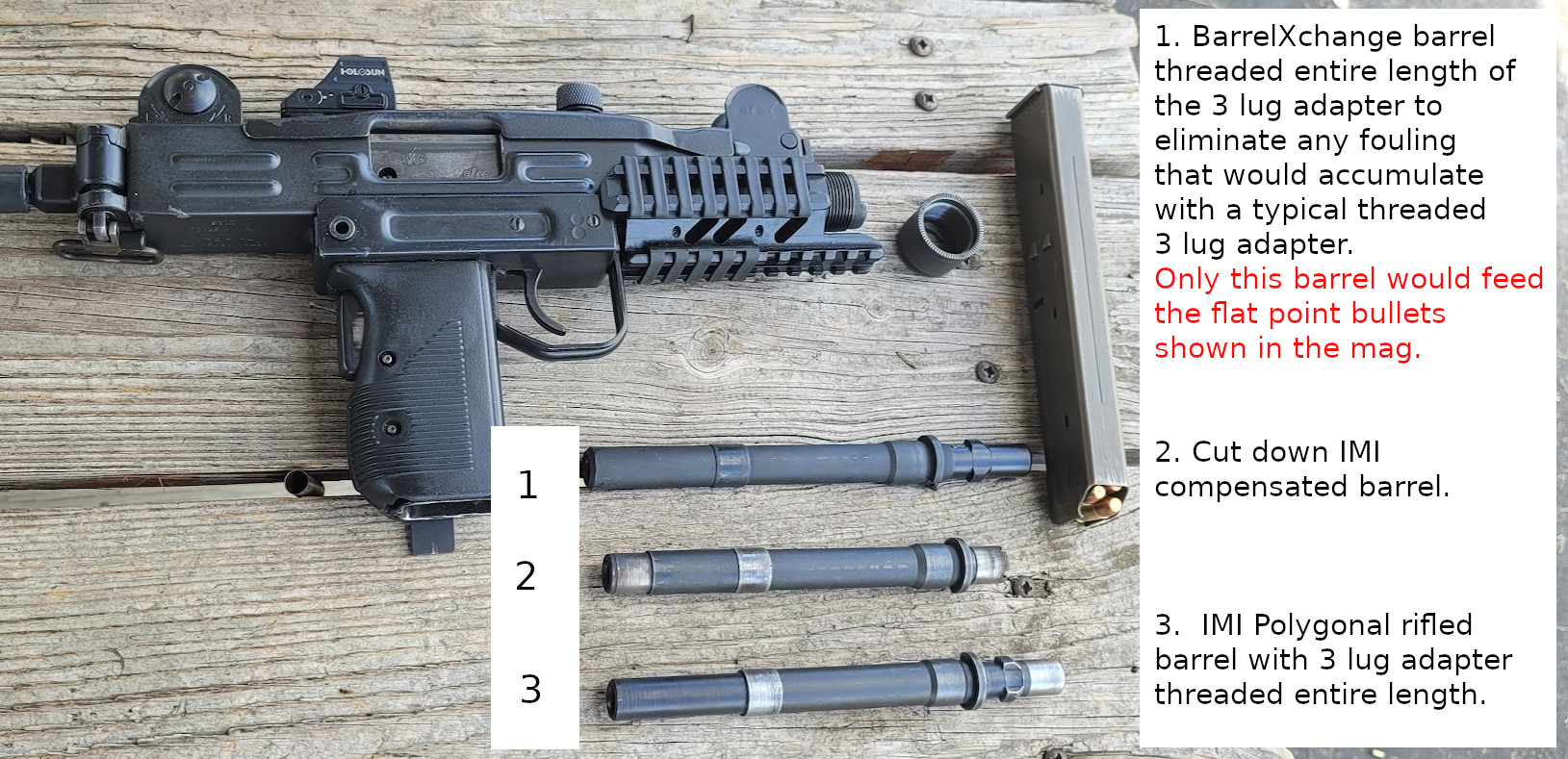

Regarding FN, I posted this before:
Now on my full size UZI's, my IMI barrels run the same FN bullets just fine.
Both my full size and my Mini have the sold semi feed ramps for better feeding.
With my hybrid full auto Dissent I have been playing with, I have 5 different feeding options.
Out of all the configurations above, the only one that feeds the FN bullets reliably are the new 40 Round MEAN Exomags. Neither the Glock or curved Scorpion mags feed them reliably. Could be my COL or whatever but I got the projectiles cheap and just burning through them. Will most likely stick with RN when I've shot them all but it is kinda fun going through different permutations to figure out what works which most likely run JHP the best if FN isn't a problem.
Video of it below
