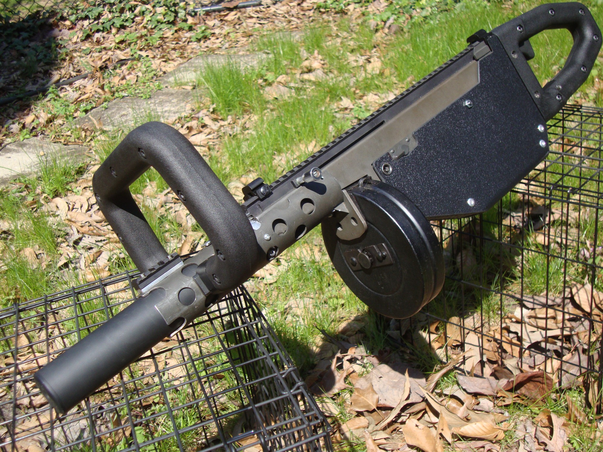

I always wanted a Machkfalaklage. Nice.
I don’t have the drum on it now, but don’t forget Suomi. And the tube in front was copied from a 1919.
The member who did one similar to this years ago used a 1919 barrel sleeve, or front thing that folds up…, what ever you call it.
8,740
My hero, DistilRadius'eses chainsaw mac..
...and winner of the Small arms review 2017 Franken Gun Challenge.
DSC0513150_zpsf761d07d.jpg~original
