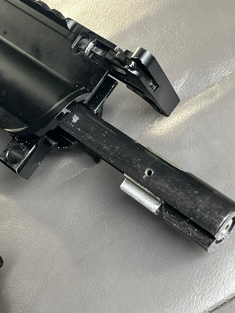

9,127
I used a drill press to cut the 1/8 hole. Sorry. I took a quick pic for another person and forgot to post it here.
