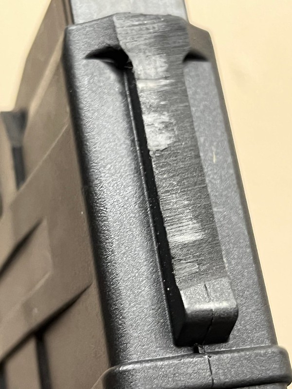

What did you do to get the 10 rd mags to work? Mine are very unreliable even on semi. The only difference seems to be the front of the 10 rd mag has some material ground off, like there were trying to remove flashing but took too much off by about .020-.025".

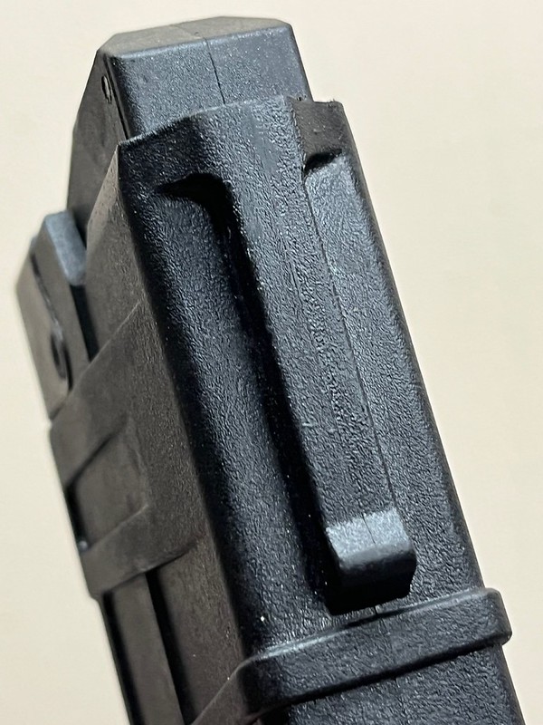

Does the rib on the front of your 10 rd mags look like they removed material? They rock in the magwell more than the 5rd.
10 RD
5 RD

The tabs all look the same. Two five round mags on the left. 10 rounds on the right

Well, PSA says the mags "are not eligible for warranty service." I used some epoxy puttty to build them up so we shall see. I will test today.

The modified 10 rd mags work better but still not as reliable as the 5 rd mags. I wonder if JTS thought that making them lean the other way was better. I will try that next. I don't mind cutting stuff up if it leads to giggling.
