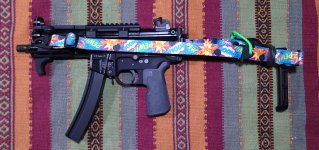

Nice think I'll buy one.
Also after looking at the site I really want one for my H&K SP5 but I'm not sure what all I need to make it run.
I'm guessing everything they have listed for the SP5.
Would that be correct?
Not difficult to do. Lee sporting lower, Hoffman SS, Rounded Hammer to mp5 profile. See pic of when I built my zenith mp5k. Upgrading though to the ARSS by As Designs as its selectable and not as finicky to trigger pressure as others. Stay away from rare breed , had one and sold it as it was super finicky. Along with how they are going after everyone making any type of SS.
