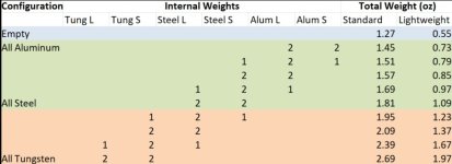

Here's a weight chart from Bore Buddy. Like Strobro, my CMMG solid weight is 1.2 ounces. I don't understand the last two columns; the "Lightweight" column is a mystery. The "Standard" appears to be the current Gen 4 weight given the configuration of internal weights to the left. Basically any internal weight will get you over 1.2 ounces and per the high speed video, that's probably desirable, although maybe overkill.
FYI and to save folks the trip to the website, the "L" and "S" probably mean "Large" and "Small"; the weight has two holes in it to house the weights, one hole smaller diameter than the other.

9,043
BB sells 3 different bolt weights, steel adjustable, AL adjustable and solid stainless. Lightweight applies to the AL.
