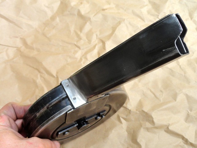

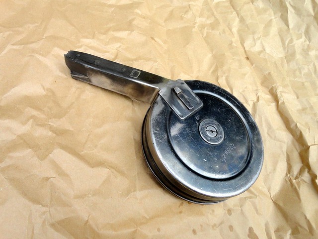

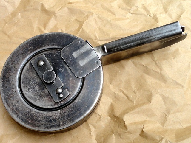

PPSH-41 drum modified for M10 45 built in 2008
I thought I was one of the only ones who made one that worked!
I recently saw Troys....Great work!!
I removed the scroll and rolled out the bead, then rolled the drum body bead flat.
I needed even more room to allow for teflon strips so I built a drum stretcher
Then weld on new tower reinforcement plate

Wow. Expanding/stretching the drum body requires some serious know-how. :bowGood job.

A 9mm is a whole lot easier....no bead rolling, stretching...and cheaper!!

I tried my hand at a Suomi/ZMAG tower this weekend. I placed the tower ammo divider bend at the wrong location in the tower and that created a pinch spot that slows down the feed rate. Looks like I will try again next week after I get another ZMAG. :)
