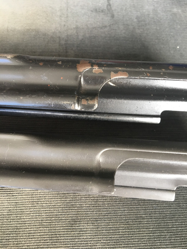

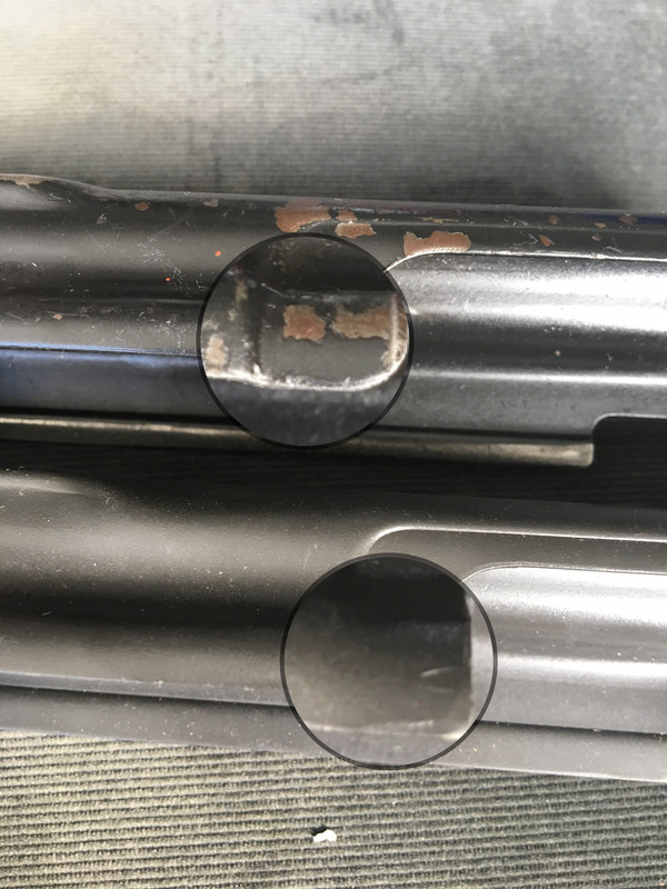

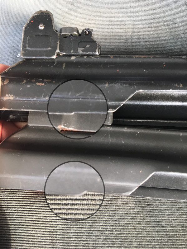

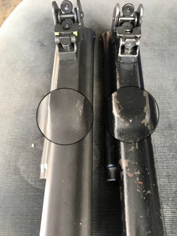

I've gone through all the pages of the excellent thread but I haven't seen discussions regarding the dust covers. I might have missed it since most of the earlier posted pics don't exist anymore. Anyway, here is my contribution on dust covers. Besides the thicker sheet metal used on R series, these are some of the minor differences I noticed between the two.
R series on the left, Galil on the right. The R series cover have a shallower bump compared to the much pointy Galil cover.
Galil on top. This section is more pronounced on the R series
Ejection port stamping is more pronounced on the Galil
Front bump is thicker and longer on the R series

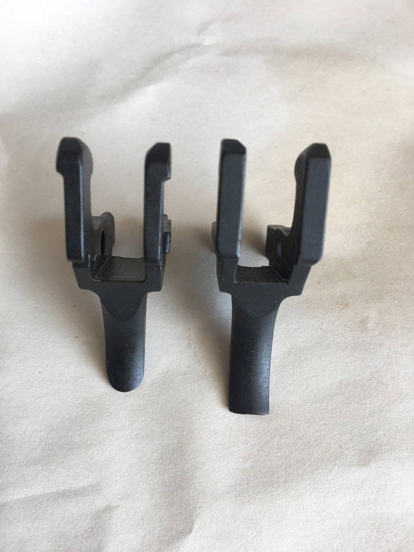

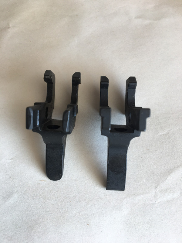

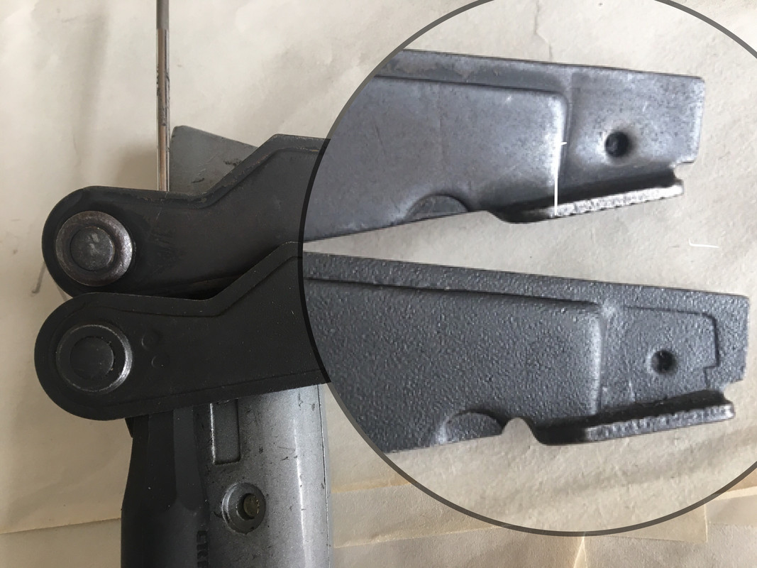

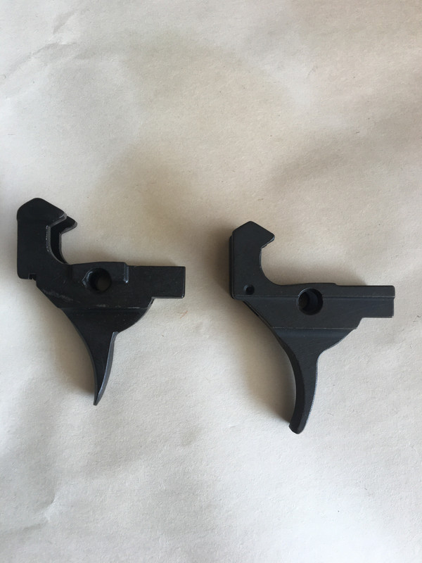

Triggers are different too.
Galil on left.
Front side Galil on left and ends are rounded. R series squared and longer
Back side Galil on left. Machining differences overall. The R series is a lot robust.

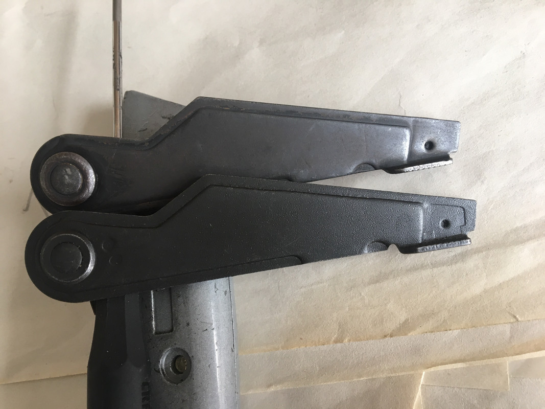

Galil on top. Very minor differences. Notch to the right of the thumb lever and different stamping on the end. The rest is identical.
I received another selector from SA and it was identical to the Galil. I believe this was the really early ones when LIW is not allowed on modifications on Galil original design.

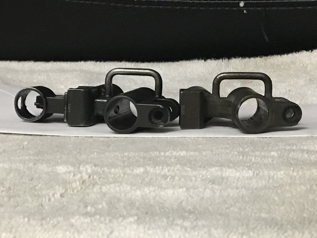

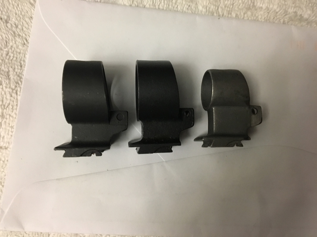

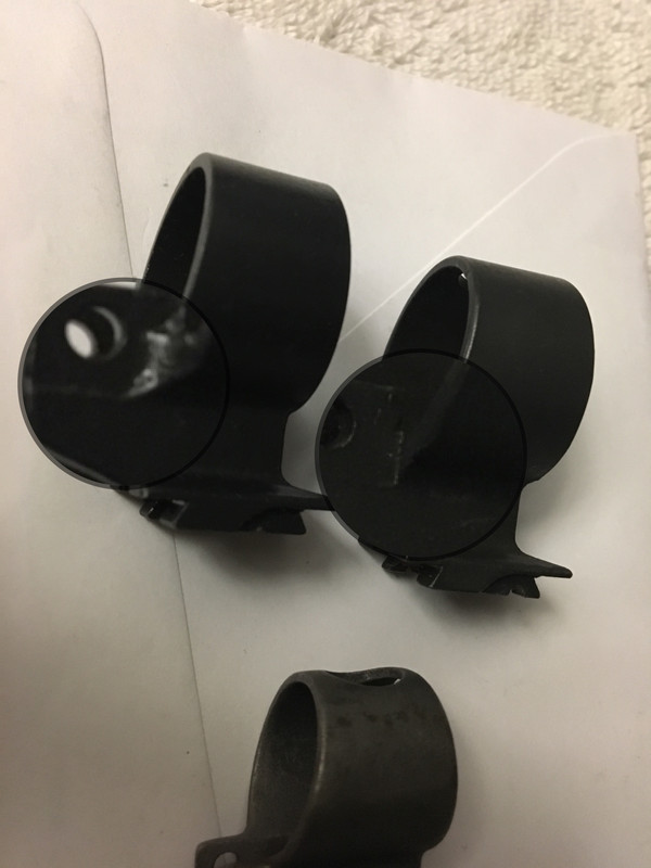

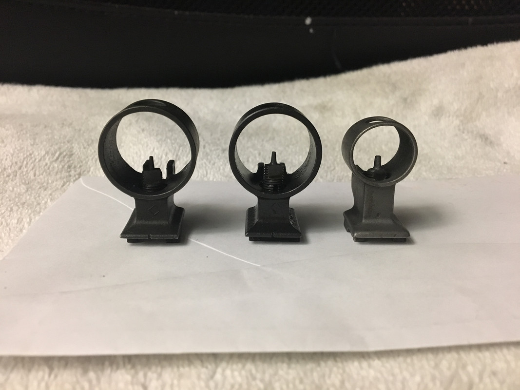

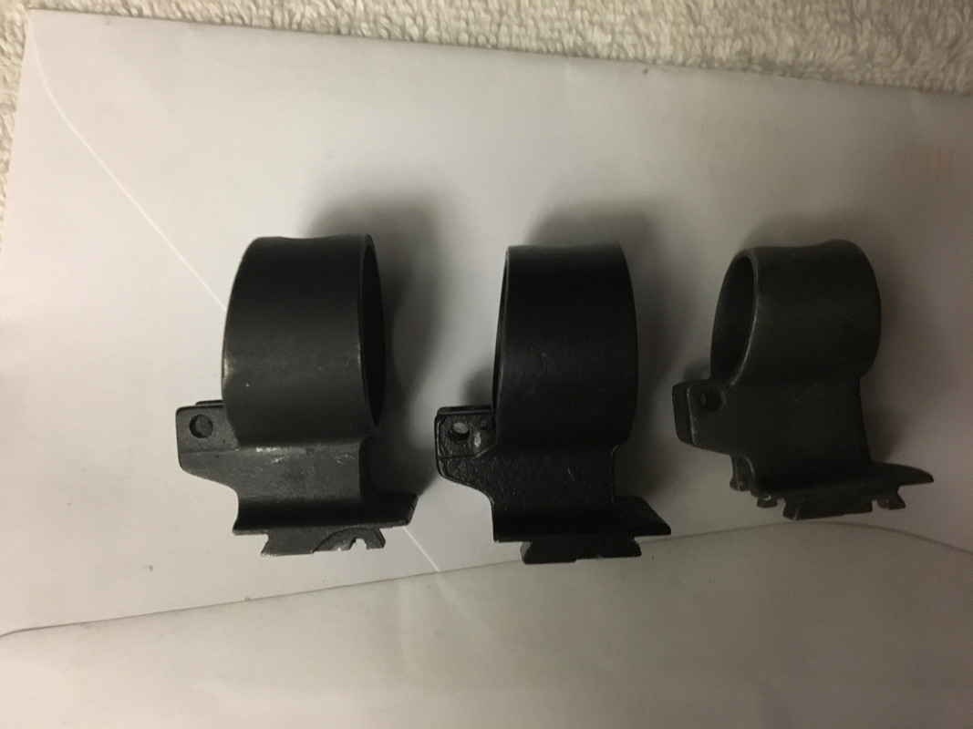

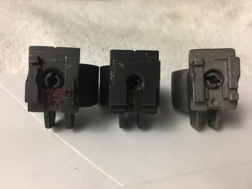

I also noticed two distinct variations on the R series front sight. As we all know, R series front sight lacks the "Z" spring. Well, there's one version that has the provision for it. Looks like this was a transitional version and was decided later on it was unnecessary.
The "Z" spring equipped SA sight have squared corners and rounded on the non equipped variant. I also found that the easiest way to install the front post if you are upgrading to the thin R series is screwing it from the bottom of the front sight assembly. Screwing it from the top is almost impossible to do due to how the legs of the post is spread out. Save yourself the trouble, install from the bottom.

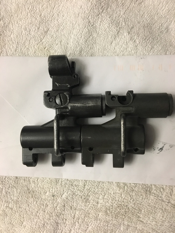

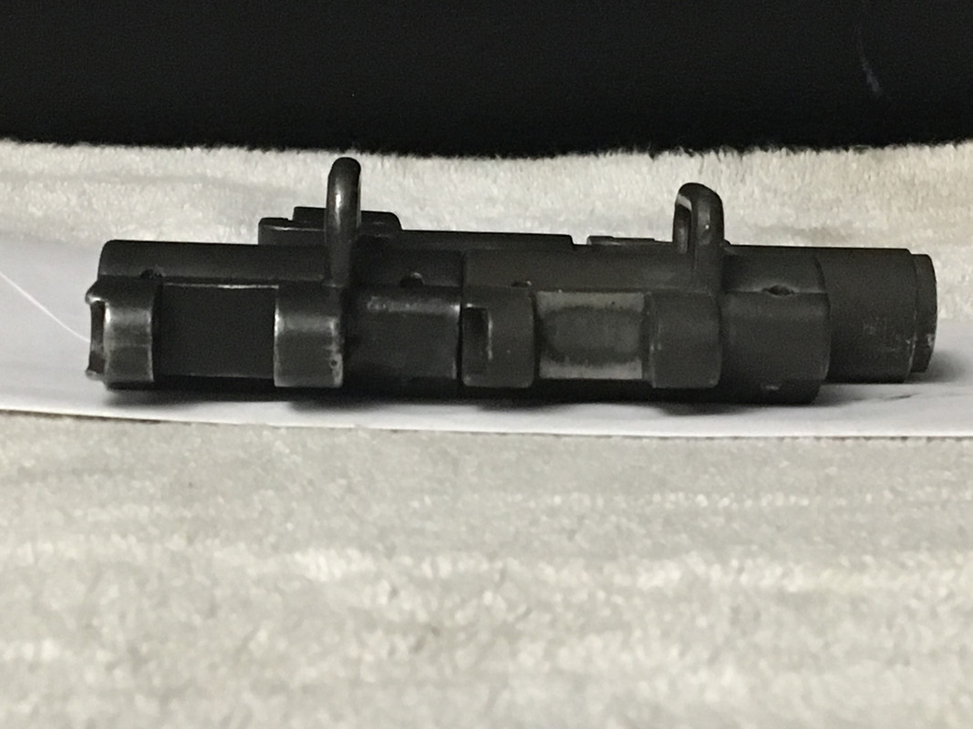

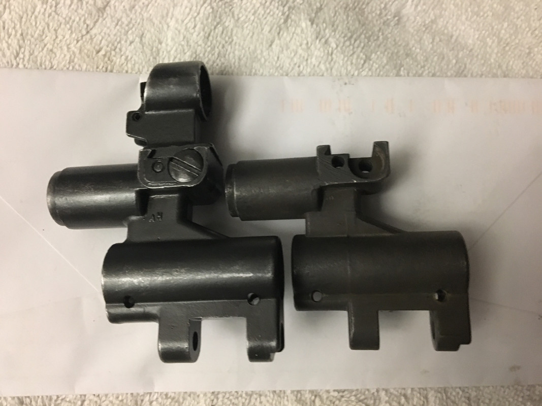

I acquired this R4 gas block(thanks to WILDCARD!)which I believe again as a very early version not like on Lou's R4 which I think is a later version. It's almost identical to the Galil with very minor differences. Most significant is the width or length of the sling loop depending on how you look at it. The R4 is a tad short compared to the Galil.
Galil is on the left with front sight assembly installed.
