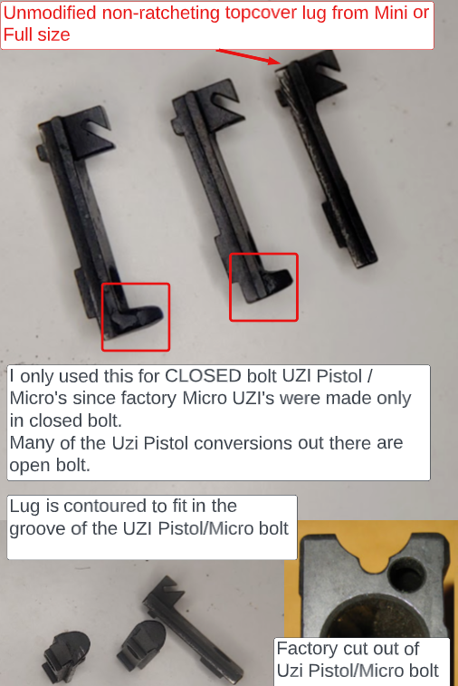

I know this has been discussed before, but my picture below is how I approach this.
I prefer this instead of using a block that gets threaded into the bolt that moves more than the topcover lug does.

Don’t understand your comment. “Moves more than top cover does.” Once in place the block doesn’t move at all
With this method you need spare parts or spare top covers to put a host back to factory configuration. With my bolts you do not
You have allen head bolts that secure the block to the bolt. What I'm saying is that those bolts can loosen up. There is no concern of that happening if you use a modified cocking lug like I'm saying and if someone has 1 registered bolt like you are trying to sell, I don't see them having multiple spare topcovers being necessary and even if they did, not a big deal to get another lug TIG welded.
Blue loctite. They don’t loosen up

The heavy bolts from barrel exchange have removable top plates. Those were no issue either
4,791
No offense but my money is on a TIG weld over Loctite. Also nothing to worry about misplacing / losing your custom block somewhere. Not saying your method won't work. Just my preference.
4,791
I know that. I have a BarrelXchange Mini / Micro 22LR bolt and I sold my Micro so I never remove the block (for full time Mini usage) and that bolt is aluminum. If I still had my Micro, I would go with a modified lug w/ a Mini topcover vs the removeable block.
Again, my preference.

And to solve that, you just don’t use my block, and leave the slot open and modify a top cover. It’s just an option

I make them to different dimensions.
Ah, so you must make them with very thin feet to run on all three guns, not the feet as shown in the photo. It's no trade secret, it's been done many times. It's nice that you make the option available to people

The removable plate is going to be the preferred option for most people that don't have access to custom TIG welding. And easier to sell later since it will appeal to more buyers.

No. I don’t make them with thin feet. As shown in the photo is complete and exactly how it runs
