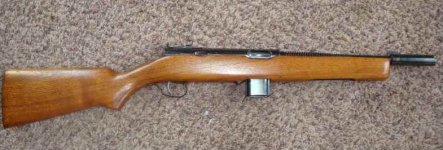

I'm not sure the date of manufacturer? The serial is in the 10k range.
