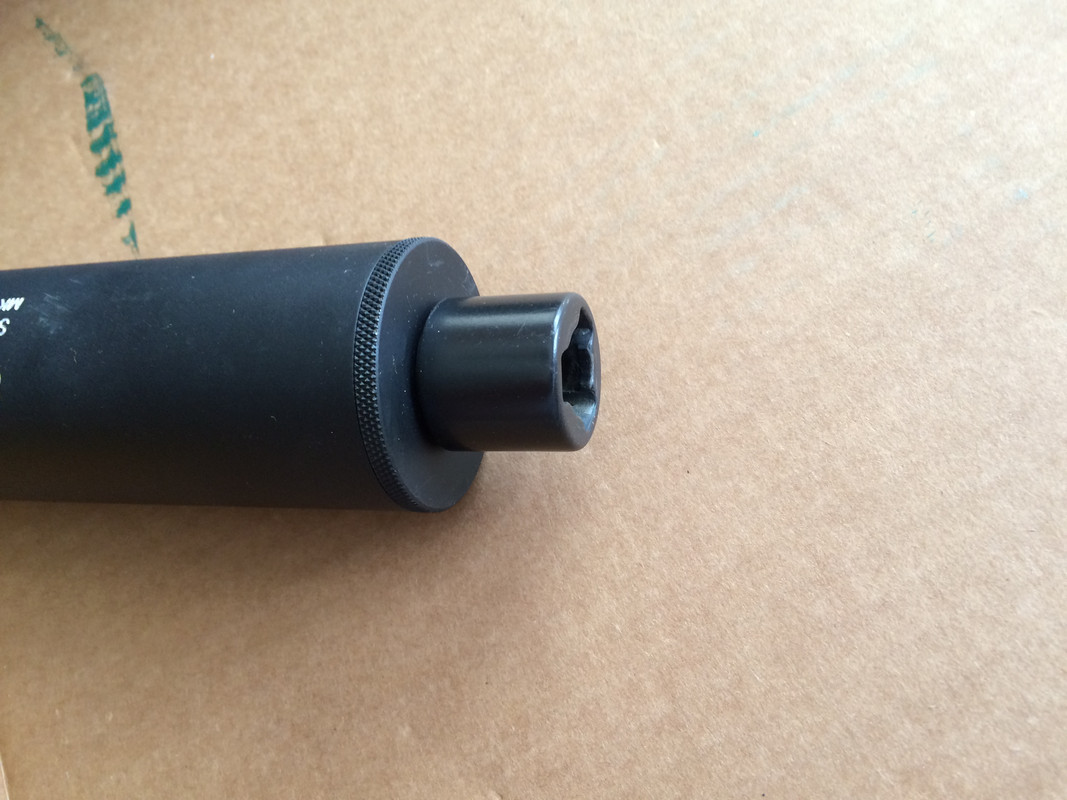

Thanks guys. Ran a SMG match with it this past weekend and put about 500 rounds through it and it was great.
Picture below comparing to a couple of my MK9K's.
Left: circa 2001 design.
Middle: actually a clone that has the ported area beefed up. I blew up an MK9K with a full auto Micro UZI. It broke right where the ports are of the inner tube. Later, I see that Gemtech made that area thicker like my clone.
The area where it is ported is also threaded so it thinner there.
The original MK9K, clone and the current Phoenix by GSL are all using an aluminum inner and outer tube, aluminum blast baffle while the rest of the baffles are SS.
With my custom can, the baffles and expansion ported area are all 17-4 SS and threaded. The ported area isn't threaded, has smaller holes and again 17-4 SS so I have a lot of confidence there won't be a failure.

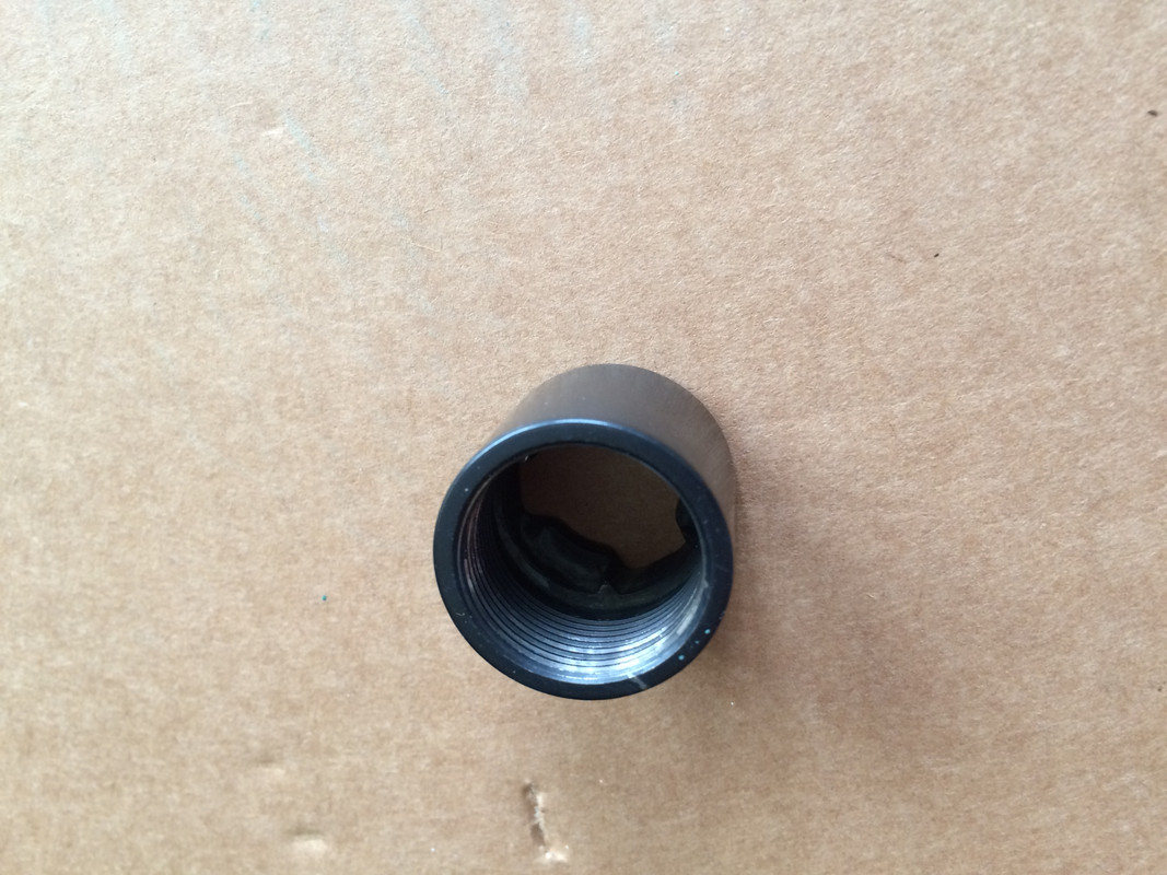

You can also see in this pic that he made the threaded area for the Bixler 3 lug mount too short compared to the middle one and I had to send it back to get re-made.
This pictures shows the internals, again everything is threaded so it eliminates the need for an inner tube which the MK9K needs.
Note the front end cap is machined for that big allen wrench and the rear mount has flats to put in a vise. The inner core being all 17-4 SS allows me to just dump it in a heated ultrasonic tank.
Mods...maybe I should have posted this in the suppressor section but initially posted here since the UZI was a primary host. I use the Gemtech UZI mount as well as the 3 lug mounts.

Check out this thread: http://www.uzitalk.com/forums/showthread.php?92307-Curtis-Tactical-s-new-CT9KS-coaxial-suppressor
I liked my first custom can so much I sent in one of my MK9K's to get chopped and new core built so I have two. I will most likely leave one setup with the UZI barrel nut mount and the other with the Bixler mount.
The Bixler mount doesn't use any springs and don't see how it can really get fouled. This design has no play.
Check out the thread above and see the great idea Joe at Curtis Tactical had to make the 3 lug mount a direct thread with a different nut.

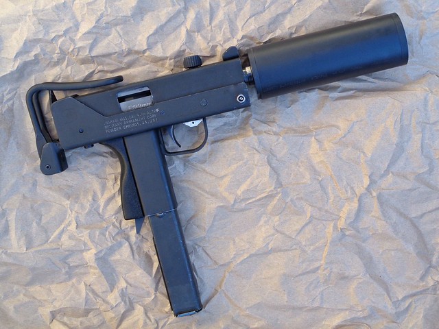

Here are a few pics of my MK-9K w/Bixler mount in detail:
(Notice how nicely it mates to an MP5 3-lug barrel tip.)
