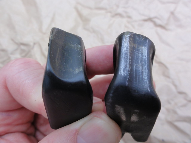

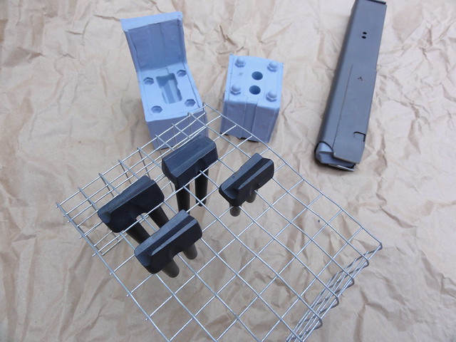

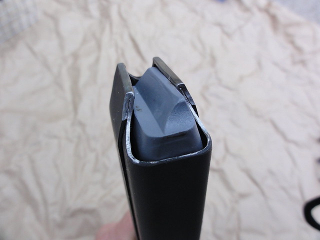

9,054
At the time zytel followers were the most reliable for 380 in the PAM2 mags.
I had 6 PAM2s and 1 zytel mag.
I used a zytel follower as a model, made a silicon mold and gravity cast in 6 urethane followers.
