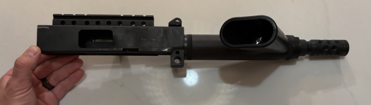

I've been meaning to post this for a while, but just didn't find the time. When I bought my M-10/9 a few years ago, it came with this upper. It has no markings, is side-charging, and, strangely, has a pistol grip on the right side of the upper, making it seem perfect for lefties (but watch your arm around the ejection port, I guess?). I did a bit of googling, not too deeply, but didn't find anything readily apparent as to its history/manufacturer.
Anyone have an idea of who made this?

Thanks for asking. Got one in the .45 and was wondering the same thing.

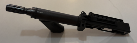

Have you been able to rotate the forward handgrip? I'm trying to get it out of the right side lefty position to a under-barrel position as seen in the catalog picture above, but man that nut behind the flash hider is seized so tight. I've about given up on it after marring the nut a bit.
1,148
Penetrating oil today, heat (if you can) tomorrow. Along with a good fitting wrench.
1,325
Have you been able to rotate the forward handgrip? I'm trying to get it out of the right side lefty position to an under-barrel position as seen in the catalog picture above, but man that nut behind the flash hider is seized so tight. I've about given up on it after marring the nut a bit.
You’re gonna have to use a blow torch. Only way I ever get these old barrels and barrel shroud nuts to loosen up personally. Hit it with the torch for a few seconds and it usually breaks loose fairly easily.

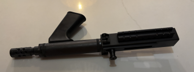

Alright, new question - Any idea of the thread pitch on the barrel of the upper? I've tried a 3/4×10 adapter like is used for standard Mac threads, but it's too big, as I figured it would be. I tried 1/2x36, but that's too small.
This is a picture of the threads, 1/2x28 on the right side for reference.
1,325
I think they’re 5/8x24 but not positive
1,382
.625-24 by the looks of it but there is no way we can tell by a photo. Youll have to measure it or try a known thread on it.
Measure the OD with calipers and use a thread checker to check the thread pitch.
1,325
This is my guess as well, but I believe this thread pitch is more commonly referred to as the fraction, “5/8x24”, easier to find muzzle adapters and attachments when searching for it this way.
