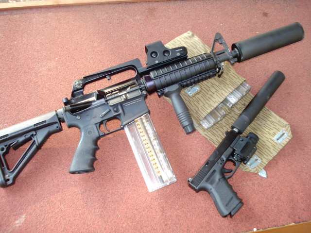

8,731
Wow. Is the design that bad? Do the 45 and 10mm bolts need replacement that often? How do they charge 1700 for a gun that needs extractor springs that often?
4,788
I know amphibian accomplished this or his gunsmith, but they didn’t share how to. Here’s I how i did it.
RIght, as I mentioned on my website, I worked on a piston operated 9mm upper with another C2 years ago and we gave up when we realized we would need a fixed ejector. He later did a fixed ejector after I had abandoned the project. I used his fixed ejector on my CMMG RDB but he told me I couldn't post pictures of it or go into details on it and I have honored his request.
https://c3junkie.com/?page_id=280
4,788
The .45ACP doesn't have this issue. At least mine doesn't have the issue nor anyone I know or have I seen posts about it.
The 9mm/.40SW and 10mm all have the issue.
I detail what I think the root cause is on my website below and it is excessive headspacing.
https://c3junkie.com/?page_id=221
Extractor spring isn't the problem, the ejector spring is.
As mentioned on my site, their ejector springs are proprietary, shorter than a standard spring but thicker gauge and different material. Retail is 1.99 each. So not bad.
I have the CMMG RDB in 9mm / .40SW and .45ACP. I am not going to bother with the fixed ejector for .40SW and don't have issues in .45ACP.
Ejector springs last about 1000 rounds for myself and friends I know. If it was 300 rounds, I would suspect the extension headspacing is extra sloppy and may need to get replaced by CMMG.
As I have illustrated in my video below, I think that if your barrel extracts the brass with no extractor installed and no suppressor mounted then you should get CMMG to replace the barrel. My early barrel was doing that and eating parts.
I showed them that video above and convinced them to replace my barrel. As I have two 9mm BCG/BBL combos early one did that but later one didn't. Same for my .40SW. It doesn't extract brass with no suppressor and no extractor.
8,731
Thanks for the info. I was considering the CMMG 45.
That's a lot of work CC. Looking forward to seeing the long term results.
8,731
I had one of the OA 9mm uppers. I can't remember a single time a case failed to eject.
1,946
That's a nice looking set up.
I've got an OA .45 ACP 16" bbl. upper and I have their special order full auto carrier in it for M16 use. Shoots very nice. I have not had any ejection failures either, but apparently, as the ejector is a spring that gets bent on every stroke of the bolt, over a long number of cycles, the ejector can fatigue and break. Some OA pistol caliber upper owners on ARFCOM have expressed dismay that replacement ejectors are no longer available.

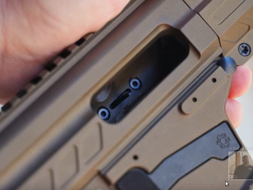

You guys may have heard CMMG's new Dissent uses a fixed ejector. Here are some pics I stole off Youtube.
Note that they moved the cam pin further back to prevent the breakage I'm experiencing.
1,946
Somewhat ironically, it appears that a fixed ejector causes other parts to break, and thus require fixing.
