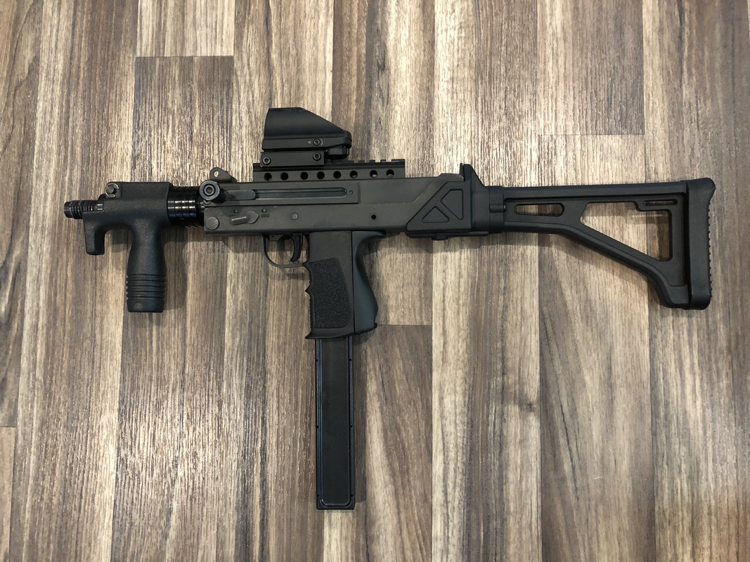

I recently purchased a M11/9. It has a grip attached to the barrel. On the 3-lug I believe. I was able to remove the top plate and pin, but not the rest. I tried to remove the plastic grip, but was not able. Maybe I didn't try hard enough. Any advice.

It looks like it is held on by barrel threads,try to twist it off.

I was told the barrel has 3-lug. The part below the plastic grip is lesser against the wrench flats on the barrel. It doesn't compress and turn like a 3-lug mount.

I gutted one once..Look for a hidden set screw and some snap ring bs somewhere.
As simple as they look ..there was a trick to getting it gone.

They just unscrew. The screw up top is to index the grip. Take the snap ring off and remove the pin, take out the screw on the top and the plastic piece will come off

Probably has a few drops of loctite. Needs effort

I had one I had to completely butcher to remove. Installed with copious rocksett or similar, and torqued to the point the threads and shoulder were deformed. That barrel become a throw away. I used all the tools of persuasion first I promise!

For those who are interested in removing a muzzle device attached using Rockett, put the barrel in the freezer. The Rocsett will break free very easily.
Good tip. I think you can boil it for a few minutes too. In this case freezing would probably be better.
