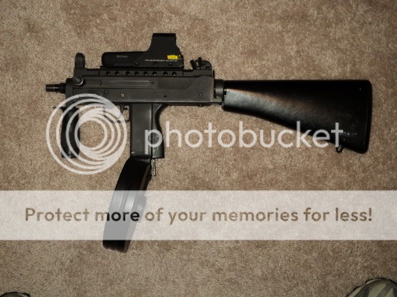

You might think about offering them on the standard uppers as well. Here's an Autowerkes upper on the M10 I used to have.
I've also got an Autowerkes upper for my M11/9. The sights were offered in "standard" and "high". Although, the high sights still sit too low to be able to use very well with an M16 stock. You might check a few of the more common stocks and set the height accordingly when you do yours.
Note where my eye is, compared to where the sights are. The Eotech is about the right height. Of course, by the time you get that high up, the sights might look pretty goofy.
