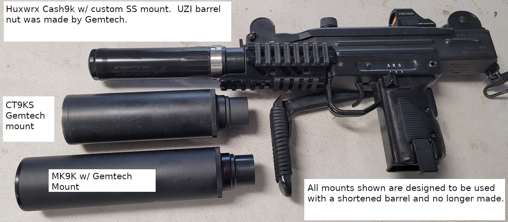

Any update on those shorter mounts? I have a gsl pheniox and fat man and wanted to order the direct Uzi mount adapter until I seen how long it is.
4,817

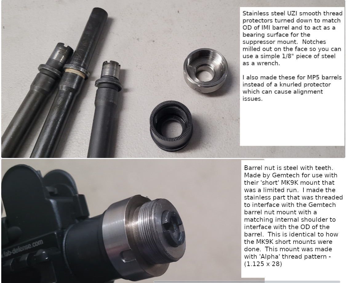

I did make the SS adapter as seen in this picture below.
Clarifying what I mentioned above regarding the remaining Gemtech inventory on the short mounts, I only got a few of the complete short mount 'sets'. Set meaning the part that threads into the can is anodized aluminum while the barrel nut is steel. I don't have more of the aluminum parts I want to sell. I do have more of the steel barrel nuts and as you can see made my own 'adapter' out of SS that is also the bearing surface for the barrel (just like Gemtech did with their aluminum version).
Obviously SS is stronger than aluminum and harder to machine. I don't want to deal with making it out of aluminum and getting it anodized and all that. Nor do I care about leaving the SS 'in the white'. I guess I could get it cerakoted if I wanted to but I don't care.
I made that part on a manual lathe so it takes a long time. If I were to sell them, I don't think I could make any money doing it. I can ask my buddy if he can do them on the CNC but not sure that is worth his time either when he is already busy making barrels for other manufacturers.
Aluminum may actually be better for the MK9K though since it is much larger diameter and making out of SS will be heavy. Titanium would be nice but I don't want to deal with machining that metal.
