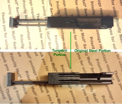

As an alternative -- though not nearly as nice nor as slow -- you could go back to the first "hybrid" style bolt that CF made. Simpler machining and less tungsten, since it was tungsten only in the rear, and attached to a cut-down steel standard M11 bolt.
I own THREE of the CF-W type bolts... a Gen 1 (above), a Gen 2, and an "A" type bolt, all in different hosts/uppers. They're all great. See the old article at https://mac-11.info/review-cf.htm
4,463
Lage has warned against using them in the 31 series, on the s and SK series it's good to go, but the regular max uppers need a spacer
Gaujo, I did a search here and on Richard's page but didn't find any info. What was the concern? I've used one for a few years in a 31A and the bolt never bottoms out and it runs very smoothly. Hopefully I haven't been doing any harm.
