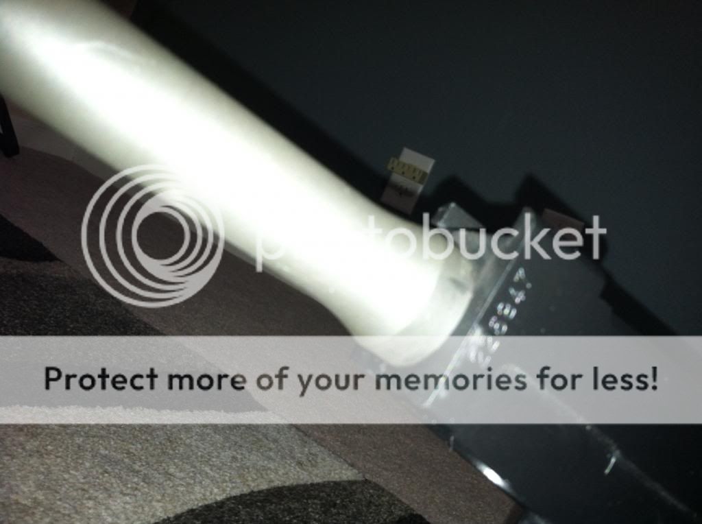

The builder told me this was a factory IMI galil barrel, however there is nothing on the barrel to identify it and I mean nothing!
I also do not see any wrench flats!
I think I need a GALIL parts kit at some point...
We're some IMI barrels made without some dates or markings?

Deltaspeed93, One of the best people to pose this question to would be Tenngalil. Adipose, Jetskratel, and Riderboy would probbaly know also. I have 2 Galils built by Tenngalil but i'm no expert on bbl markings. I know that some builds require cutting bbl's down thus removing some bbl markings.
Is your bbl chrome lined? If so ir could be a IMI bbl.You may need to take the handguard off and possibily have some markings underneath.
Try contacting one of the above, or take off your handguard and see if there are any marking underneath.

I am gonna say that you do not have a original IMI made barrel. All original IMI barrels that I have seen have the wrench flats on the barrel. Another thing to look for is the factory pressure proof stamp it should be the letter "P" within a circle (although sometimes its just a "P"). I have a barrel just like you described and it is a US made one with a nitride finish. I post some pictures tonight of some examples maybe that will help out determine what barrel you have. Adipose will tell you in a snap if you take some pictures of your barrel.

Don't give up hope. Is it chrome lined? I had some CL virgin barrels years ago that had no wrench flats. Jeff just milled the flats on one of them and installed it.
But a "galil parts kit" does not have to mean it's Israeli made......
Whatever it is, shoot it and enjoy.

Could be a custom-turned barrel.
I'm a bit perplexed how they managed to torque it on the receiver with no flats, since it isn't a press-and-pin receiver.

Yeah, my sig has a press and pin 552 fitted barrel to a 556 receiver done by estes adams. Pretty cool but I'm always worried the thing is going to come apart but a grade 8 bolt should hold.
When I was looking at the galil I was also wondering how they did it with no flats?
I spoke with the shop owner and he seemed genuine about were the barrel came from.
It will be interesting trying to identify.
Are galil barrels pretty easy to come by? I think I want to just go the ar route and get the standard IMI handguards and barrel
