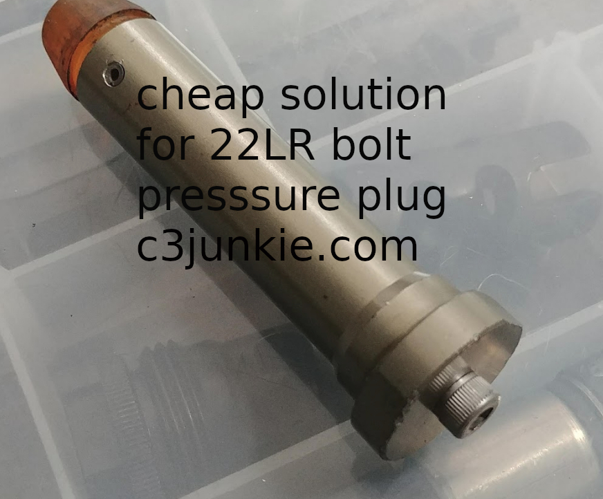

My cheap solution I did like 20+ years ago:

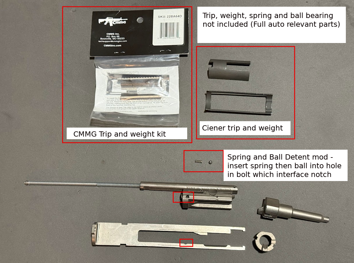

Those of us "old timers" might still recall the Spike's Tactical .22LR AR-15/M16 conversion assembly that counteracted bolt bounce by incorporating both a relatively light (~0.7 oz.) anti-bounce weight and a so-called ball-detent (i.e., a spring- loaded ball in the bolt that intersected into notches in the inner right side frame rail).
4,817
A guy that posted on AR15.com back in the day that I think went by the name 'Swede' or something like that came up with that idea.
My friend that was making the kits for Spike's later incorporated that into those kits.
Picture of this mod below is from my website of when I was selling those kits.

How effective was that spring and ball detent mod ?

Hi All,
ball detent works great. My kits will run w/o the ABW with the ball detent installed.
BTW, putting the ball in is challenging. I cut a sliver of CC as wide as the rail to keep the ball/spring in place over the bumps. Is there a better method of installing the ball?
Enjoy,
K2
ps. I found the ball detent mod on AR15.com 20+ years ago. My kits were not reliable until I did the mod. My kits also have the timing set late.

I had a Spike's .22LR conversion kit in the 2010 or so time frame. Like so many things firearms related, I found the ball-detent to be firearm configuration and ammo dependent. With the M16 configuration that I had at the time, and any "zippy" ammo, the ball-detent was insufficient to counteract the bolt bounce. At the time, I tried heavier and lighter recoil springs as that was the suggestion prevalent back then, to no avail. As it turned out, the shooting range where I had been shooting at the time became unavailable, so I sold the M16 to one party, and the Spike's kit to another.
Some time later, I was able to find another place to shoot full auto, bought another M16, and now mostly use any of several CMMG .22LR conversions or dedicated uppers, and my self-made AWBs of a weight that works with the configuration and ammo I'm using.
I still have a ball and spring, and could probably drill one or more bolts and notch or more right-side frame rails, but why when it's so easy to just slip cheap ABWs in and out?
Best of luck.
MHO, YMMV, etc.
