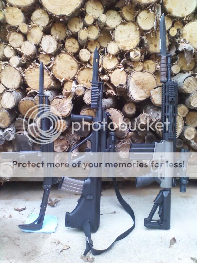

Stayed up last night with a needle file and the Dremel fitting the bayonet. Went to bed at 12:30, but definitely worth the effort:
