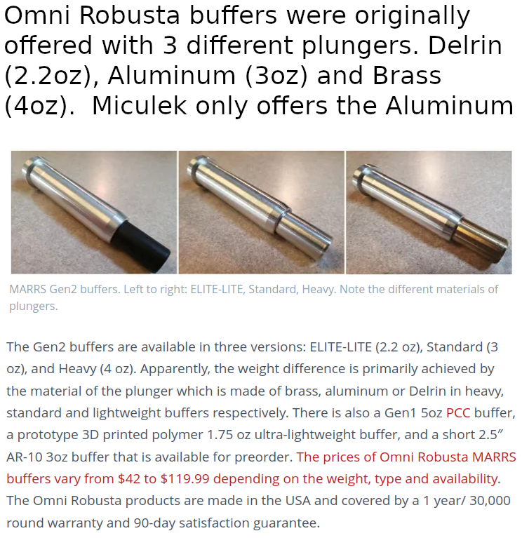

Also, magnetic buffers for firearms have been around for decades. Some time ago famous competitive shooter Jerry Mickulek (sp?) invented and sold a patented, adjustable AR magnetic buffer. He sold the patent to a company that was still selling them as of a few years ago.
And of course KynSHOT sells their patented, adjustable dampening hydraulic buffered shotgun stock apparatus, which I have - it is great for shooting slugs (deer hunting). And I've got their RB5000 buffer in an AR-15 for 5.56x45 use.

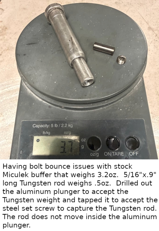

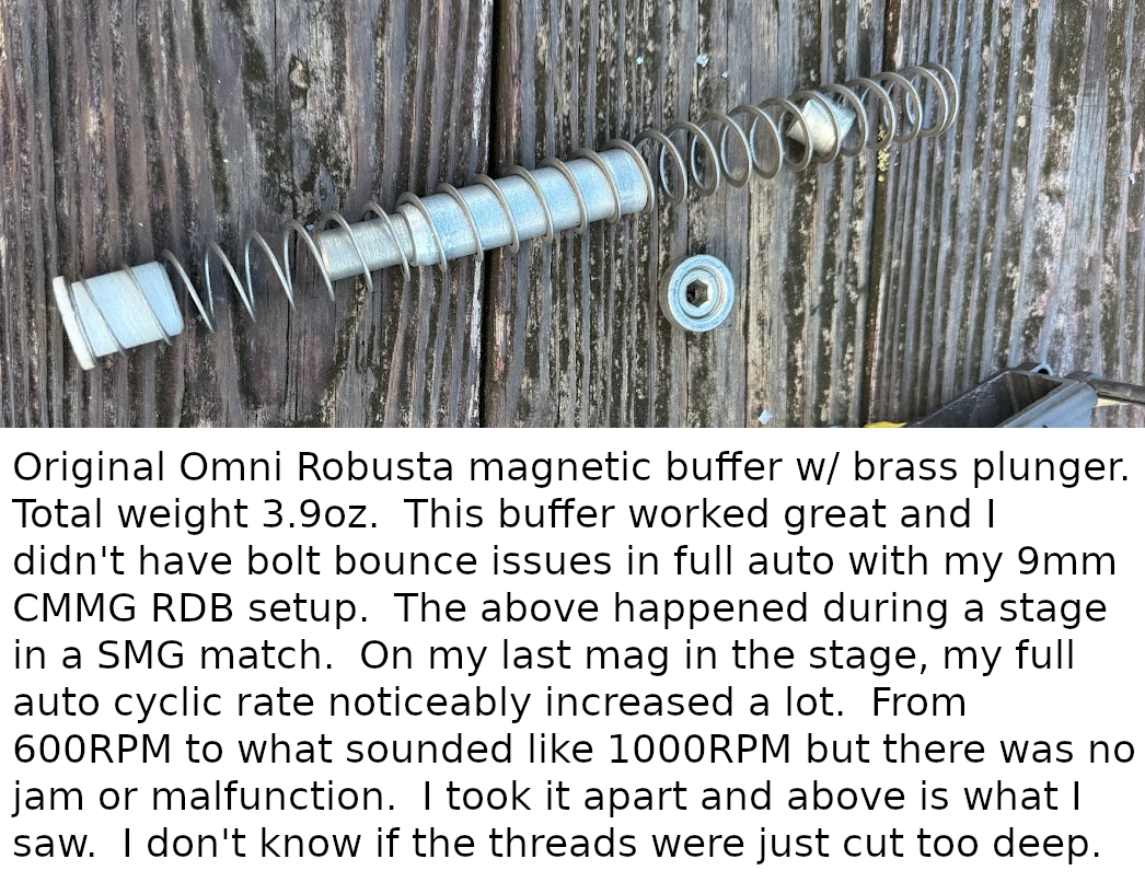

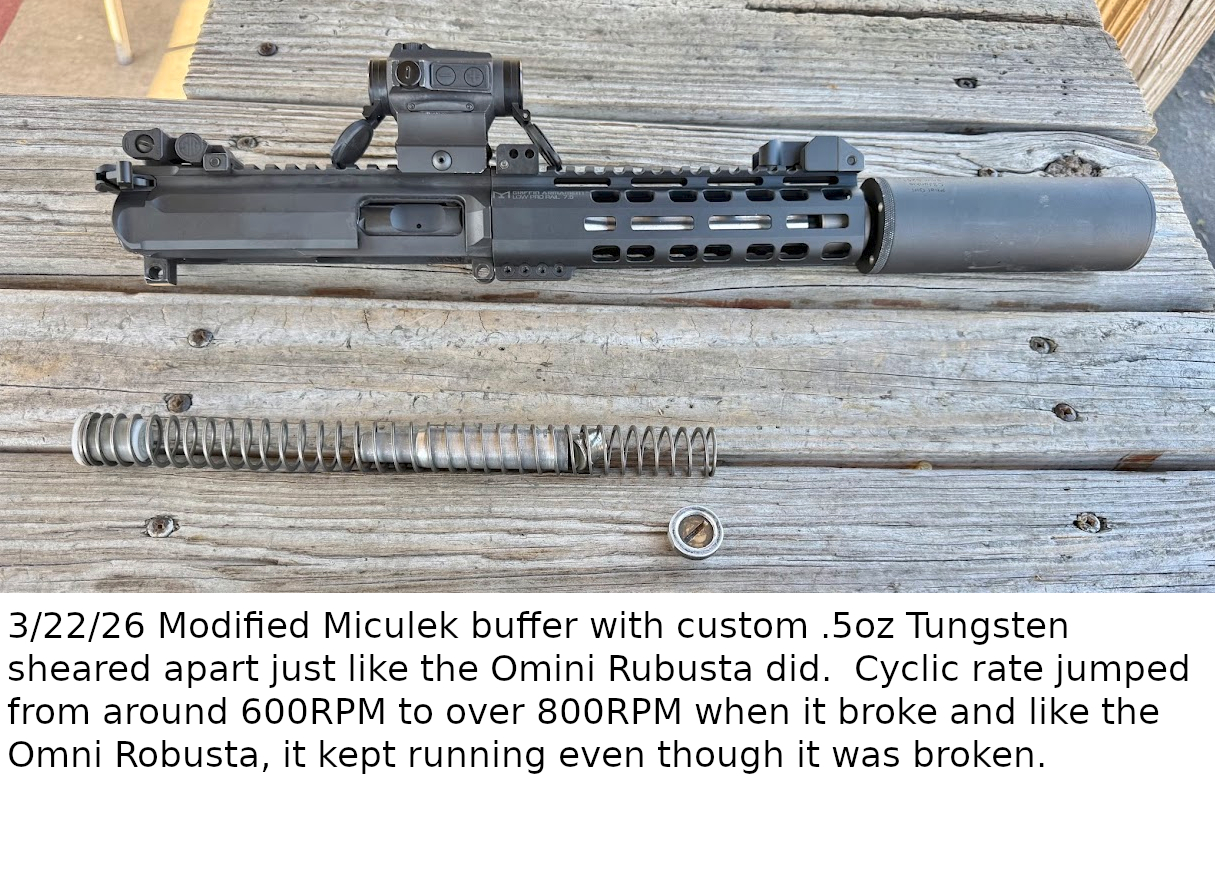

No... Jerry didn't invent that buffer. Bradley Snyder invented it and his company was Omni Robusta. I have one which broke. He sold his IP to Jerry Miculek.
Here is Bradley's patent.
https://patents.google.com/patent/US11187477B2
I just communicated with him last week.
This is an original Omni Robusta buffer with the brass plunger that failed on me.
Jerry only copied the aluminum one which doesn't have enough mass to stop bolt bounce.
I modified it with a Tungsten insert to stop bolt bounce in full auto.
This eventually failed as well.
I have since made my own magnetic that has had several thousand rounds of full auto on it and that haven't broken it yet.
