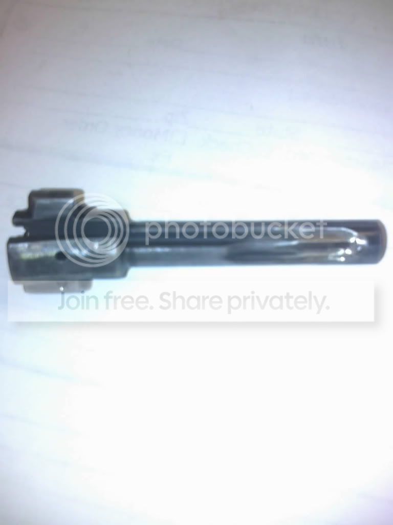

The next parts fitting issue came from the bolt itself. Even though the bolt assembly and receiver were both sold by ORF, they did not mesh well without alteration. The relief in the bolt body that allows for the ejector to flow untouched through its slot in the bolt was not made long enough for the .308 receiver. It was shorter, much like that seen on the bolt of a standard AK-47. It needed to be elongated to allow proper function in the ORF .308 receiver. The bolt is an awkward item to try to clamp in the milling machine. I had to alter a V-block and V-block clamp to get it to hold securely. THE BOLT IS HARD!!! Anything less than a carbide end mill is a waste of time and will just result in dulling your tool. Once the cuts were made and the relief elongated, the bolt moved uninterrupted in the receiver, and all was well with the world.
There was one more alteration to the bolt assembly, with regards to the extractor, but that will be covered after barreling the action (as it was the order in which these challenges were encountered).

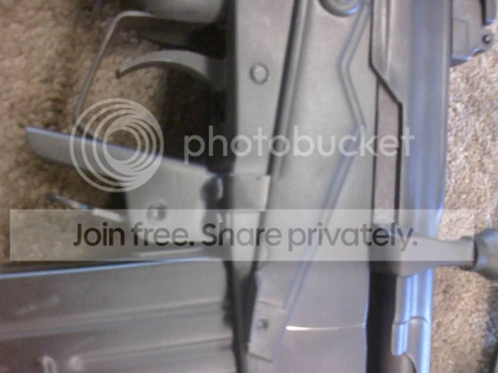

Before riveting the trigger guard, bullet guide and magazine catch/selector stop into place, I test fit them also. Two things stood out more to me that needed to be corrected. The first of which was the selector stop. As my parts kit was originally a .223/5.56, the selector stop was made to sit about a half or three quarters of an inch forward of where It actually now sits. This is a result of the larger magazine of the .308. The magazine well being larger moves the magazine catch and slide stop rearward, and as a result the selector stop no longer reaches the selector when it is in the “fire” position. I tig welded an additional quarter of an inch onto the selector stop and removed metal until the selector came to rest against it when it was also in the “fire” position groove.
The second thing that I needed to do as a result of this dimensional difference between the .223 and .308 receivers was alter the trigger guard. The original trigger guard was much too long to fit without alteration, and it just so happened that the one from my kit wasn’t in the best of shape, so I opted to fabricate my own from spring steel. For the purists out there, you can contour yours how you please, but I went with a little more angular look and enlarged the guard a bit. It kind of reminds me of the “winter” type trigger guards that are made to be used with gloves. But I did it not for gloved use, only for cosmetic effect, I think it looks cooler.

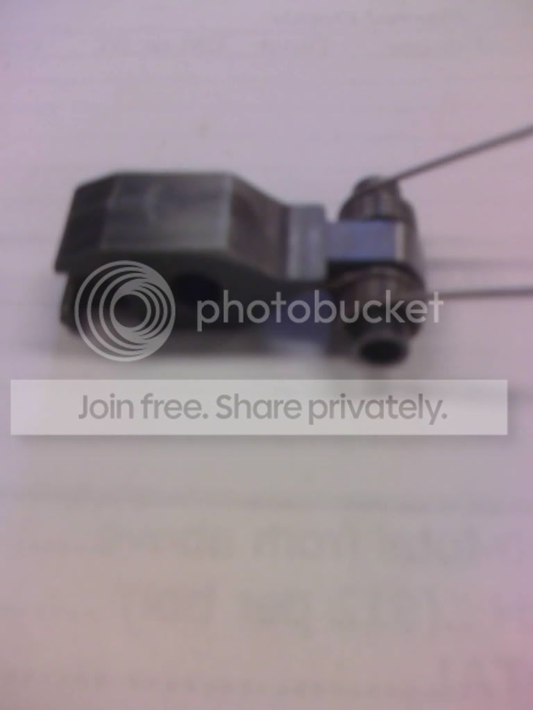

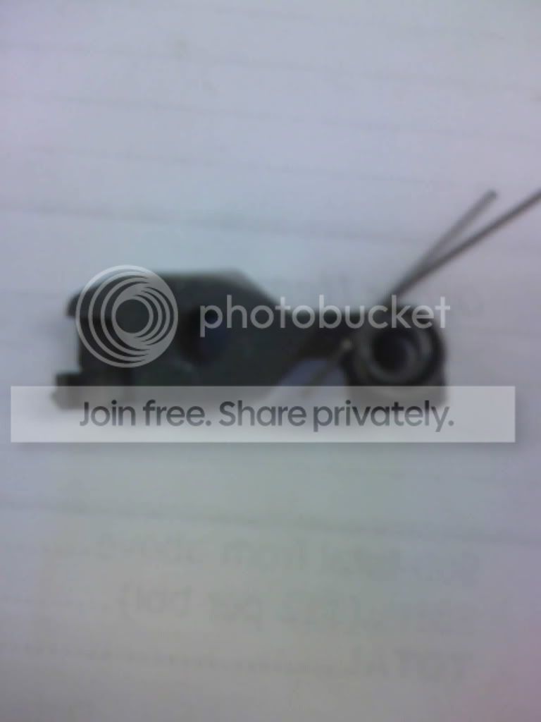

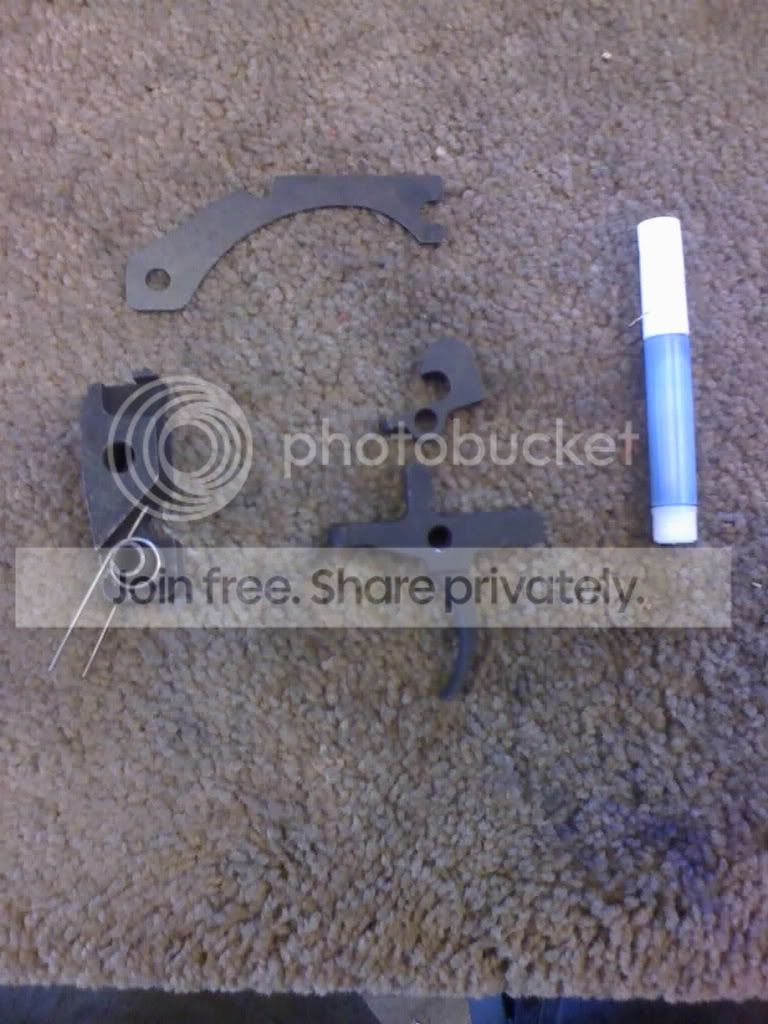

The third incompatibility issue with the magazine well being larger was with the hammer. I am not sure about all triggers, but I believe it is a safe assumption that most AK type triggers will need to be altered in some way to clear the direct interference with the magazine itself. I used the JARD fully adjustable two-pound trigger. I voided my warranty by making it work in my Galil. To make it fit and function properly in my rifle I had to remove approximately a quarter of an inch from the face of the hammer, below the bolt contact point. I milled a ramp between the different levels to minimize the possibility of binding with the bolt carrier (pictured)
This is how it arrived:
And this is the hammer after being milled:
The JARD all in all it is a great trigger group. I only have two real complaints about this trigger group. One is in the setscrews; the setscrews were too short to properly adjust the trigger in this application. Also the trigger group was shipped without the proper Allen head wrench needed for adjustment. If these groups were shipped with the proper wrench, it would greatly prevent stripping by using an undersized but functional Allen wrench. My other complaint is that the hammer has enough lateral play in it to prevent proper interaction with the trigger and disconnector, It is easily fixed by adding a spacer like a washer to the right hand side of the hammer to take up the slack and center the hammer in the receiver. (The shepherds crook type pin retainers, and the pin retaining plate to my findings would not hold the FCG pins in place so I used cotter pins, like the type you see on a RC car body.)

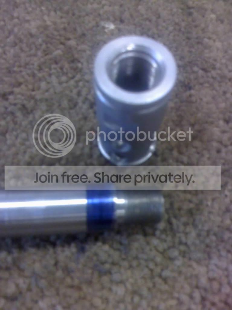

After the receiver was riveted, and the above-mentioned parts were altered and meshing well, I mapped out the barrel’s thread extension. If you are using a pre-manufactured, IMI or Green Mountain barrel, you can likely disregard this section. This here is how I turned my barrel down from a cylinder blank, Dimensions here may vary depending on receiver and bolt types and dimensions, so I am not going to give my dimensions to attempt to stay away from having any liability in other people’s builds. I will say however that I threaded the barrel at 25 x 1.5mm RH, Which is the standard extension thread size for the IMI .308s. I am specifying because of ORF offers three receiver types in the 308s. I used the receiver’s inside dimensions to determine the amount of the extension I would thread, and I turned down the slimmer rearward most part of the barrel extension so that it would just slide past the bullet guide, and stop at just .010” short of contacting the bolt. Chambering and headspacing was done in the standard fashion.
While this picture was taken after the thread extension was cut, You can see it well.
This is the barrel on the receiver, chambered and headspaced and waiting.

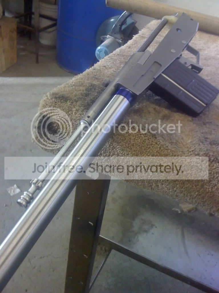

Once the barrel was on the receiver, I was caught in a state of limbo. I wasn’t sure which direction I was going to be headed with my build. I was contemplating a heavy barrel for quite some time, and was waiting on parts to do so. As time went on, and I wasn’t able to acquire the parts to build it as a heavy barrel, I began to drool over the half finished build. I had enough parts to finish the build as an AR, and this is where the build begins to take its current shape.

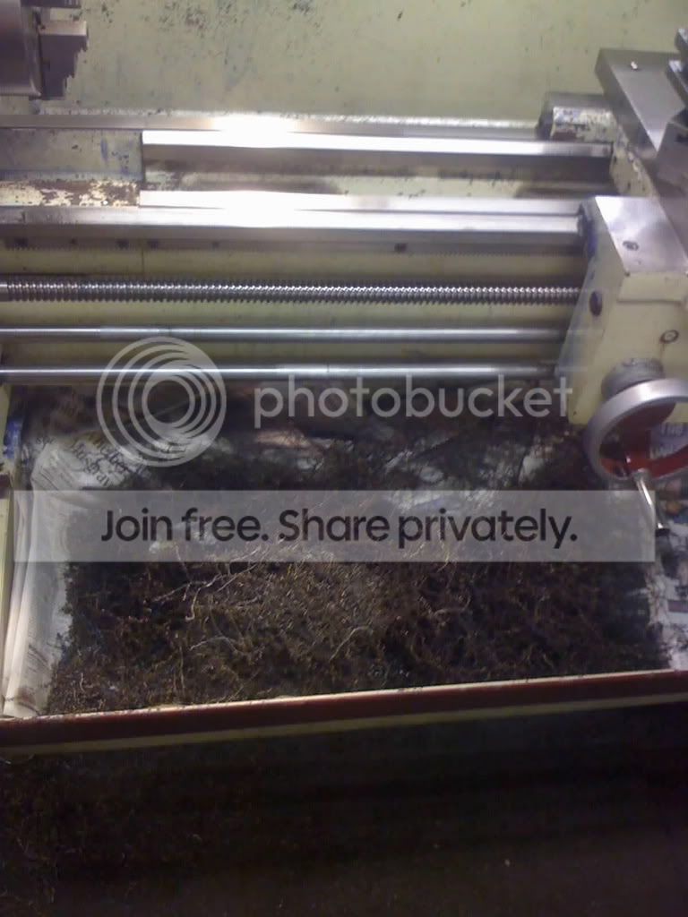

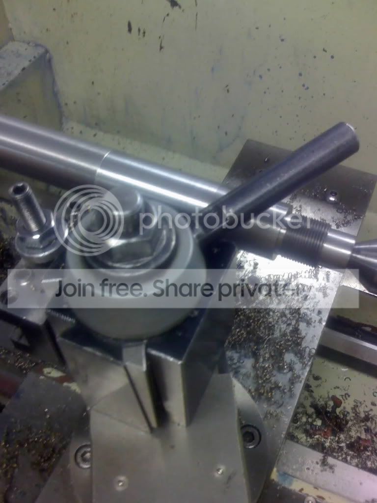

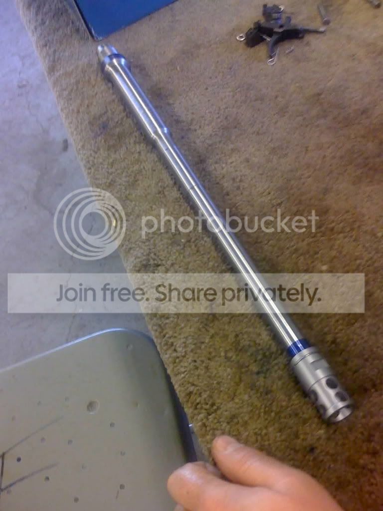

I spent an entire day at school on the lathe turning the barrel down. I do not recommend doing this if you have enough extra cash to buy one ready to build. I used the inside dimensions of the handguard, handguard retainer, and gas block to determine the dimensions of the heaviest barrel I could make.
This is the result of hours of lathe time, approximately 6lbs of wasted steel.
I turned my torque shoulder down to 1.200” and opened up the rear handguard retainer to fit the larger torque shoulder. I opened up the retainer from 1” even to 1.2” by bead blasting off the original finish, covering the retainer in dicam blue, and scribing a line with the calipers 0.1” from the previous inside dimension. Then I used a dremel to grind it out to the scribed line.
As I turned the barrel down to the inside dimensions of the front handguard retainer, and gas block (within .002” of spec) I stopped using the cutting tools and switched to using emery cloth to polish the machining marks out of the barrel and allow the tightest possible fit and seal to the gas block.
At this point I tightened the barrel to the receiver to torque spec to install the barrel components. I polished the barrel under the gas block so that the barrel to block was a 1 to 1 fit, and I tapped the block into place with a plastic hammer until the gas cylinder was tight to the dust cover. Using a machinist’s level, I leveled the top of the gas block to the receiver and used a hand drill (and the largest bit that fit easily through the gas hole in the block) to start the outer gas port expansion chamber. I made very sure to do little more than mark the location of the port. Use caution when using a hand drill to start drilling the gas port. Drilling too far with the larger size drill bit can and may well render the barrel useless. Use a piece of masking tape on the bit if needed to monitor depth of hole. After the larger hole was started, I removed the gas block. On the milling machine with an adjustable head, set the angle to somewhere close near thirty degrees, (I am not 100% on the angle. Some people say twenty-seven degrees.) Using a drill chuck in the mill and a center drill of just smaller than the diameter of the previous bit I continued drilling the hole until the hole was into the barrel enough to stabilize the 1.8mm (.070”) bit for the actual gas port. Use light pressure, sharp bit and cutting oil to minimize burring in the bore. I do not recommend doing this by hand. Although it is possible, it is likely that over penetration will occur. After drilling I deburred the barrel where it was drilled, installed the front handguard retainer (In other builds, I have forgotten this step, It makes things more difficult that necessary), and reinstalled the gas block. I reinstalled and leveled the gas block in the same fashion as previously described. Once installed and leveled again, it is time drill for the gas block retaining pins. I used a bit that fit tightly into the holed previously drilled in the gas block. The bit tracked well into the previous holes and it was about as simple as possible. I then installed the roll pins provided in the kit.

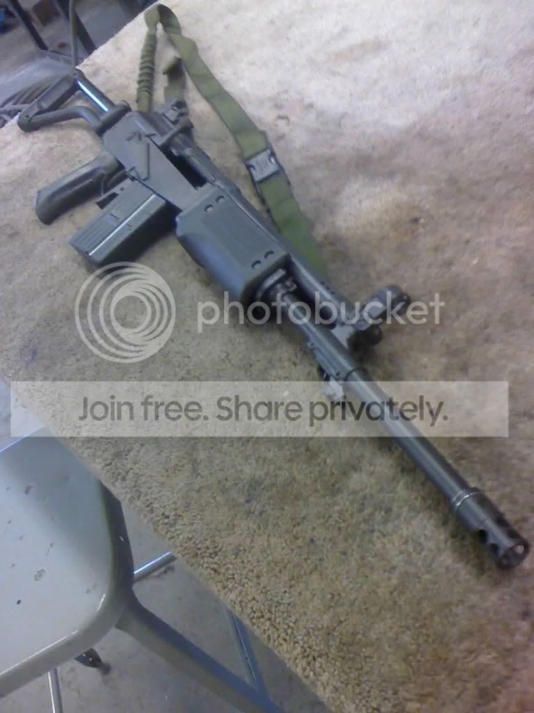

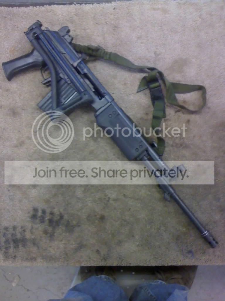

It was at this point that I assembled the rifle in its entirety. Upon installing the rest of the parts and attempting to cycle dummy rounds, I came to the following realization. The extractor was not working properly, and I had not made my extractor cut. (It was my previous opinion that the extractor appeared to be flush fit with the bolt and that with the .010” breech clearance it was not going to interfere with the operation. I was incorrect in that assumption.) While the bolt face itself is proper for the .308 cartridge, I found that other than the bolt body alteration mentioned above, the extractor too needed a little attention. In its “factory” configuration, the extractor of the ORF distributed IMI bolt assembly did not allow the bolt to close fully. The extractor being just a bit over-size would not allow it to travel around the rim of the case upon the closing of the bolt. The result was a bolt that would sit approximately 1/8 of an inch out of battery. A little dremel tool action was all that was needed to remove a slight amount of metal from the claw. When altered, the extractor functioned well and the bolt closed properly. I re-hardened the extractor after the alteration by heating to red with a torch and quenching in oil. I noticed a few marks on the barrel from contact with the extractor. And came to the conclusion that the extractor cut was in fact necessary. On the upside, using a quarter inch ball end mill, the extractor cut can be made with the barrel on the receiver. If you do choose to make the extractor cut while the barrel is mounted on the receiver, do so carefully. With an extractor relief depth of .025” the extractor has complete clearance of my barrel, and upon reassembly Dummy rounds were extracted and ejected with authority.

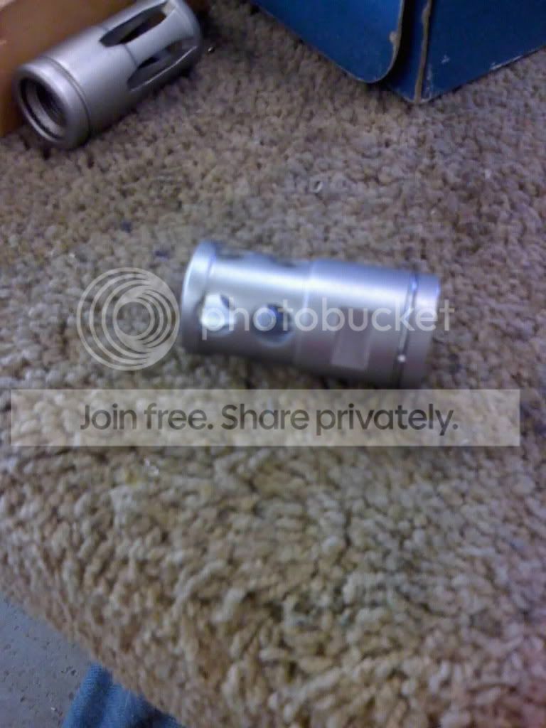

I almost forgot the muzzle brake, I made the muzzle brake from a solid bar of 1018 steel, I really liked the look of an IMI eight port brake, but couldn’t find one. The birdcage type that came with my kit was beat, and I had some free time. So I did it up. The one not so true to spec thing about it is that its threaded at ½ x 28 tpi, but since I was turning my own barrel, it was a non-issue. (It’s even got the grenade retainer ring.)

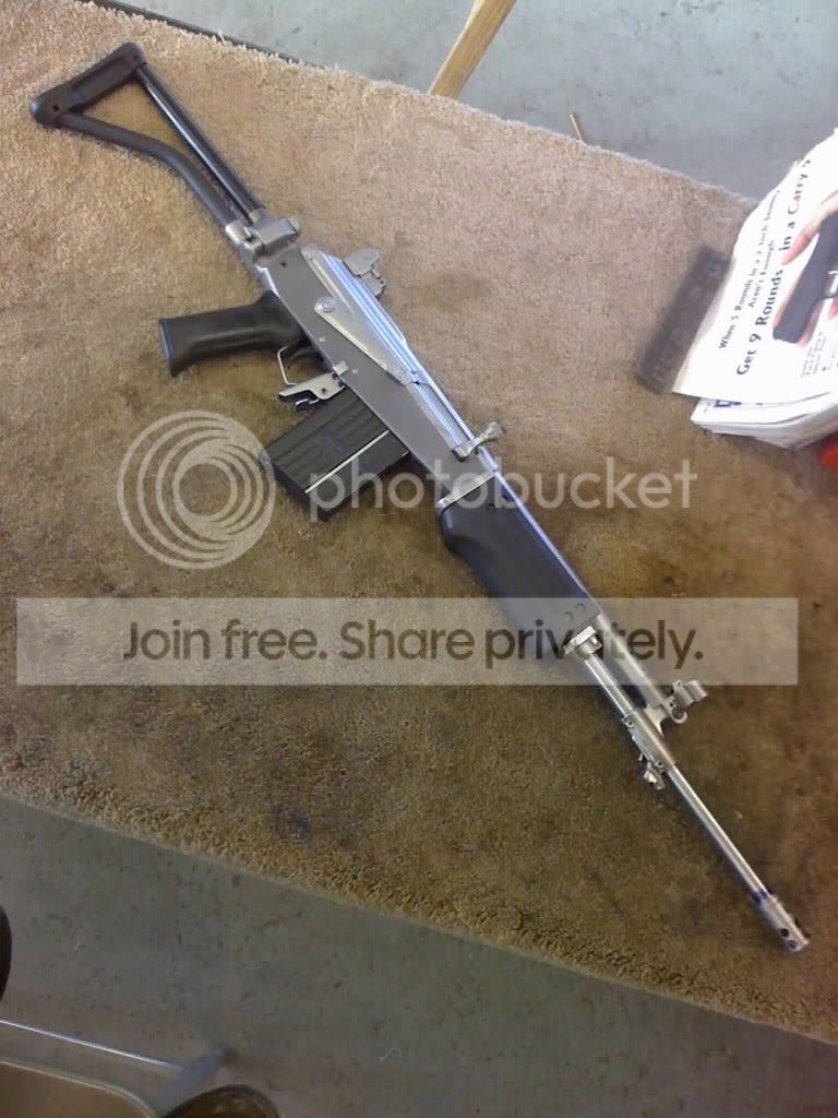

The rest of the build is the installing the sights, some roll pins, and basic AK style assembly. And refinishing is also pretty standard. If I missed anything important, I’ll try to post it in a response to this, and If anybody has any questions let me know. Happy building!
Done
And I know I posted this one on another thread, but it makes me look good.
