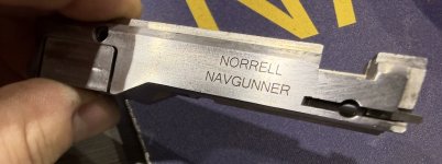

When I release these for sale, I’m going to first contact people on my waiting list. If I don’t get an answer, I’m going to immediately go to the next person on the list. Whatever remains will go on the website. Please know that we’re making a very limited amount as I have to source out of production bolts to use as hosts.
The “we”:
I’m happy to announce that NavGunner is working directly with John Norrell on these 10/22 bolts. We’re making them to John’s latest NORRELL spec. as these are specifically designed for use with his registered trigger packs.
Bolts will be marked with both the NORRELL name and NavGunner’s hallmark. The pocket for the reciprocating weight now cut using modern EDM so we’re able to incorporate a radius feature where I’ve heard complaints of breakage due to stress concentrations. I expect to have these available to ship in the next couple weeks.

I’m not going to offer a modification service but I’d be willing to offer a credit for people that want to send in their oem Ruger bolts. I need to see pictures of them before acceptance because there are multiple versions and I can only use one type. If this is something that you’re interested in, please go ahead and send me pictures now.
@nklf please send me a private message with your phone number, email. First and last name.
As of today, my waitlist matches the number of bolts that we’ll make so if I need to add a couple of bolts at the list, I need to know ASAP

This run of bolts are designed / manufactured to specifically work with registered NORRELL MGs and I'm very thankful that John Norrell himself has signed onto the project.
