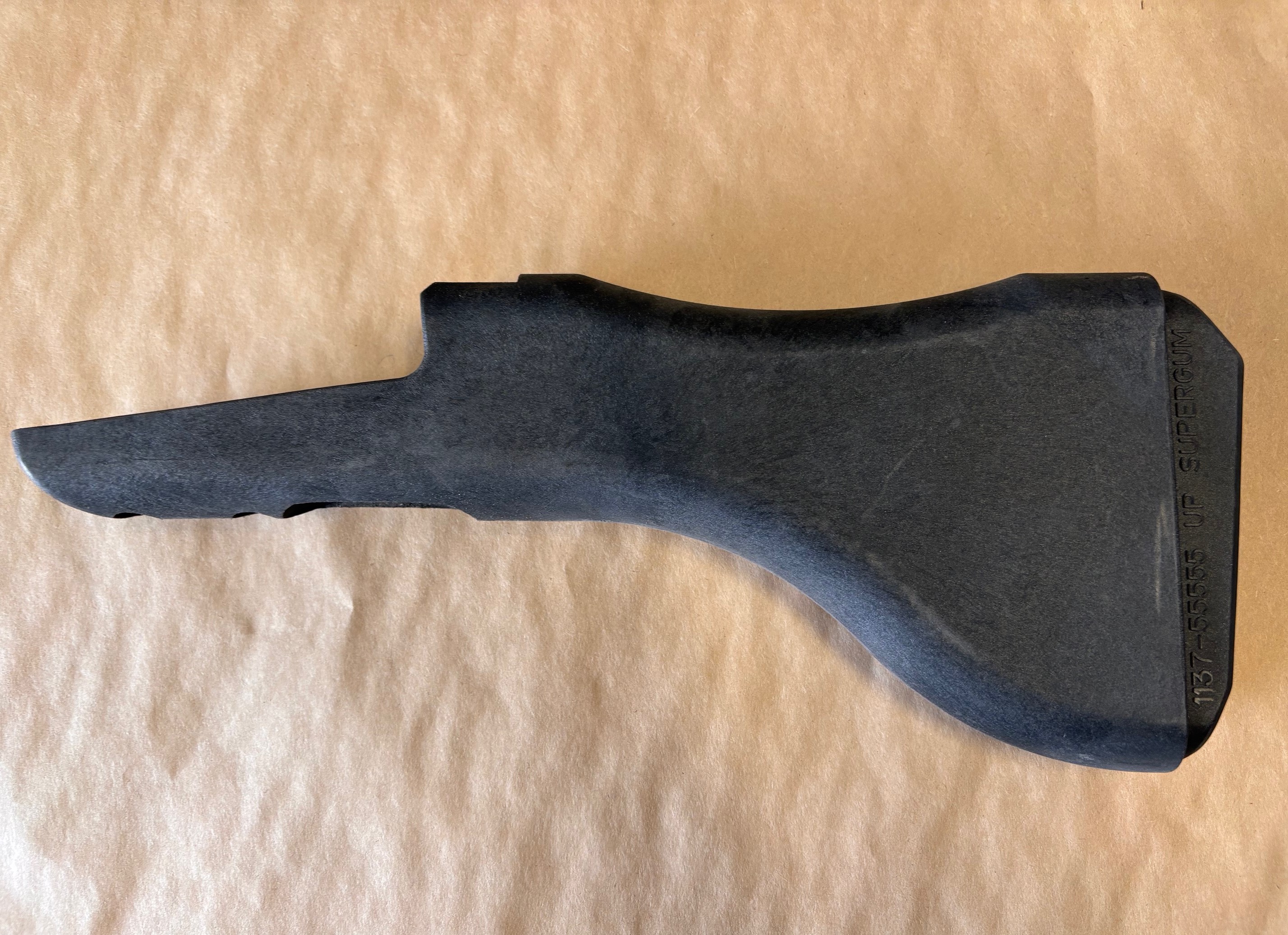

I modified the hardware from one of those brand new blonde Uzi stocks I got from RTG Parts years ago to fit a mini Uzi. The one difference from the og IMI stocks is that the metal bracket from the blonde stock is threaded for the machine screws whereas the og ones have threaded inserts pressed into the wood. Also note that you must machine a slot in the black plastic stock to accommodate the quick release lever. Also notice the plastic stock is about an inch longer than the wood stock:

Interesting. That wood stock would be very short on a Mini UZI. Mini UZI stocks are generally longer than the stock on a full size UZI to make up for the shorter receiver on the Mini.

Haha, replying to myself. I should have mentioned that the blonde stock was for a full size Uzi which I then modified to fit a home built Mini that utilized the rear receiver section from a full size Uzi… This won’t work for a real Mini which isn’t set up for quick release rigid stocks.
