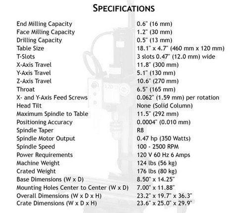

Look into offerings by Little Machine Shop. Also maybe check out this thread on a different forum:
3,592
I have a Sherline mill. The founder past away a few years ago but the company has continued 100%. Staggering amount of accessories, like rotary table, etc etc. Can be purchased as CNC or upgraded from their manual to CNC.
https://www.sherline.com/sherline-vertical-milling-machines/
That said, taking bites out of steel is limited like .010” so for any real work I take to a friend that has a “real” [Bridgeport] mill to get work done.
For aluminum, a Sherline is okay, still .020” max, its limitations are what had me move towards 3d printing long ago. A manual mill is like an Etch-a-sketch, any changes you have to start over. 3D was a game changer. If I bought a new mill today I’d have to jump straight to a Haas Mini, the rest including Tormach are all toys.
Last thing I made in 2018 on the Sherline. A switchblade .22lr single shot top break with a folding trigger. Meant to carry like a pocket knife. The Sherline mill has some value, but it’s SLOW compared to anything proper.
