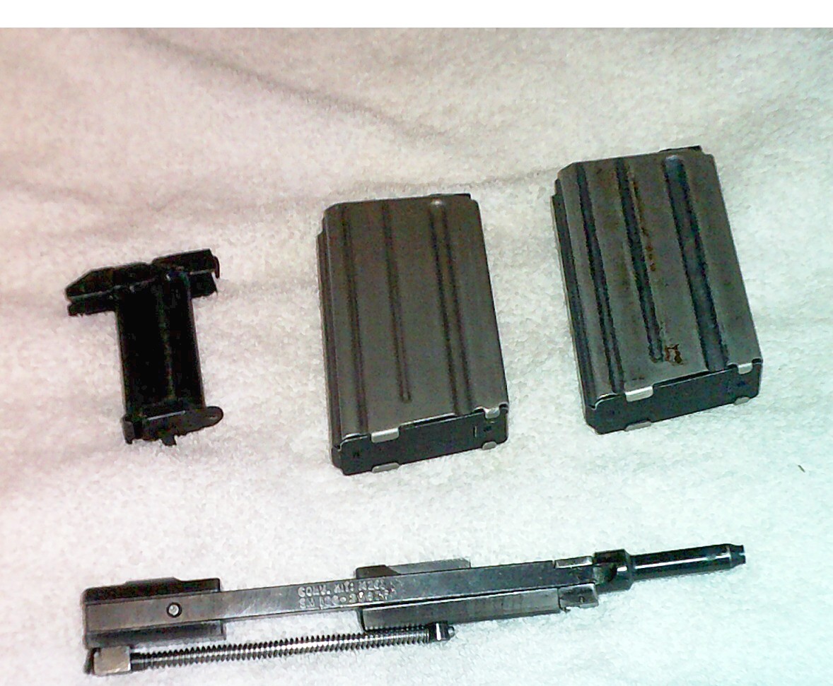

I have a USGI M261 conversion kit, for way over 20 years, and it performs perfectly in my AR that has a 5.56 chamber every time I use it, as long as I use HV .22
