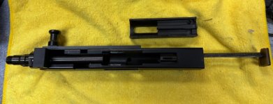

.32 in a Shockwave mag...
The Vz61 bolt on top. Looks "similar" to the m11/9 bolt but too wide to fit the m11/9. But, maybe, an M10? Side cocking, top ejecting, etc.IMG_2002.JPG Vz61 bolt on left.JPG
