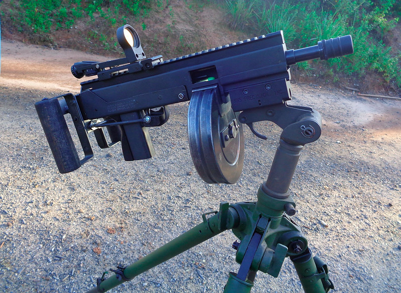

A few other neat MAC related things from "back in the day"

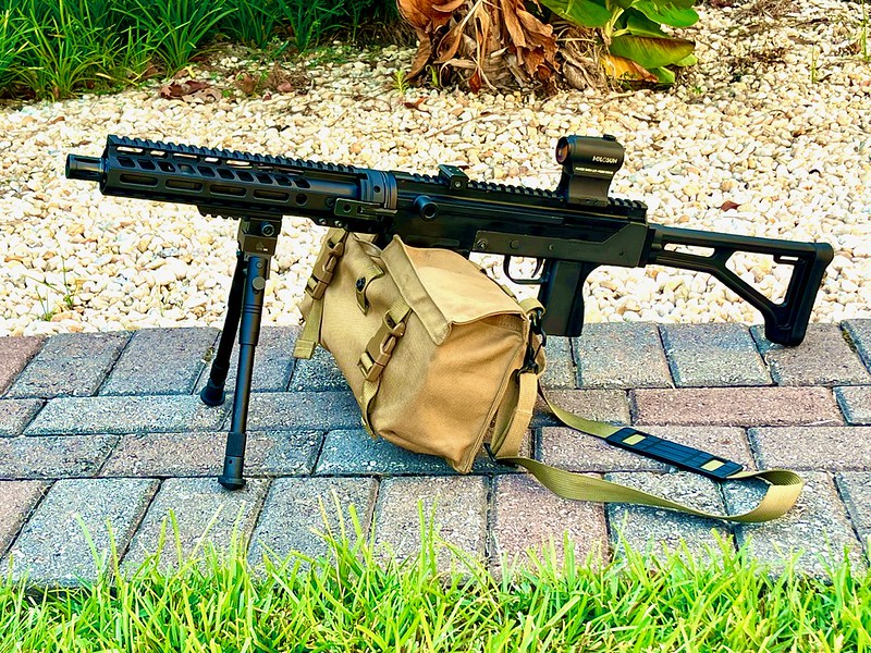

The new hotness. :)

Strobro32 that video of you shooting the Glock-Beta drums was hilarious.
9,127
You mean Greg Carlson's 556 Hollywood Blaster Comp? Works about the same on Richards 556 upper. It's like looking into the sun. :)

Strobro I thought you were out of the baby mac game!? Or is that an M10? I hadn't even thought about those dual glock drums!
