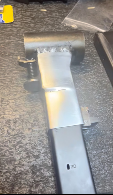

The zmag adapter works great. I cut the tower off a Sten magwell. Welded on a m11/9 magwell. Couple height adjustments. Works well. Just needs a little blending and paint. It’s about 2” longer than a standard Sten magwell. Runs about 99%!

Nice man.
