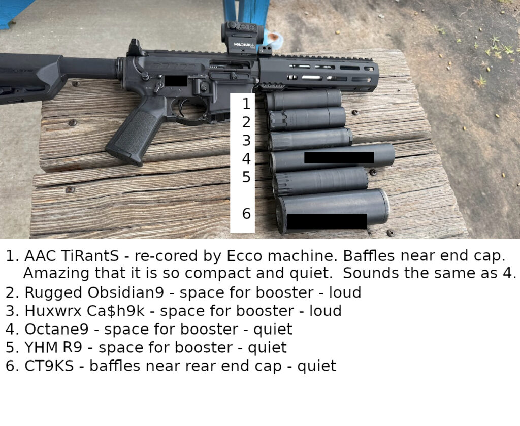

So.....I've been working on an ADJUSTABLE SD for the CMMG RDB setup in 9mm as mentioned on my site here: https://c3junkie.com/?page_id=3816
I have been very impressed how an SD chamber can make a small, LW can sound great.
That said, I am also working on a .45 CMMG RDB integral setup as well. Yes, I know 45ACP is already predominately subsonic but IMHO, porting has 3 advantages off the top of my head.
  1. Brings round down subsonic - (not applicable for 45)
  2. Brings the pressure down so the suppressor doesn't have to work as hard so you can get away with a smaller / lighter can
  3. Smoothes out the recoil impulse. Some of you may have seen that my early 9mm SD I did, I only used 6 ports to get to a state where the carrier doesn't bottom out in the buffer tube.
All that said, I'm after the bottom 2 goals for .45ACP.
In my picture above, I have all those cans setup for Alpha threads and many .45 cans also come with Alpha threads since they are used on pistols. I will be able to share some parts I'm using for 9mm for .45 but I will at minimum have to get at least 1 part different for .45 than 9mm with my design.
