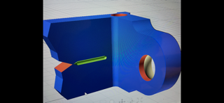

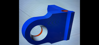

3d is worth it.
back In 2015 the hotness was a lulzbot mini that self leveled before each print. The nozzle would touch each corner of the print bed and offset any leveling difference in the software. Cutting edge at the time instead of leveling issues with other printers. I sold a ww2 nazi Browning Hi Power pistol for $1500 to offset the cost of purchase plus supplies.
That printer is still available today, nice hardware… would I go back in time and do it again? Yes. It’s been worth it, still is today.
These sights were prototyped (CAD designed by me) along with the similar peep sights, physical copies made for testing on my printer, then an investment cast mold was made for production.
So that product is due to my design, and printer. Various other projects and training with others have originated from the 1st step of selling that pistol.
